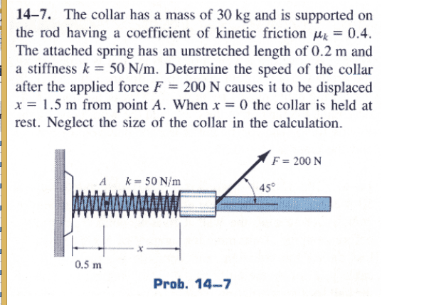

The collar has a mass of 30 kg and is supported on the rod having a coefficient of kinetic friction of 0.4. The attached spring has an unstretched length of 0.2 m and a stiffness of k =50 N/m. Determine the speed of the collar after the applied force F= 200N causes it to be displaced x=1.5 m from point A. When x=0 the collar is held at rest. Neglect the size of the collar in the calculation.

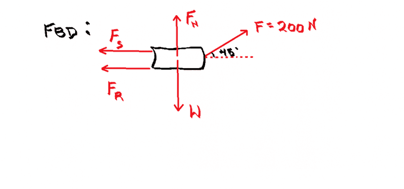

I already did the summation of forces in the y direction and found the normal force and used that to find the frictional force.
What I'm really confused about is how to know what length to use for the spring. If someone could explain to me why they use certain lengths for certain potential energies it would help me a lot! I also don't understand why they subtracted 0.5 from 0.2 to get the movable end?

  • Handwritten free-body diagram of a collar on a rod, labelled FBD, showing normal force F_N up, weight W down, spring force F_S and friction F_R to the left, and applied force F = 200 N at 45 degrees up and to the right.

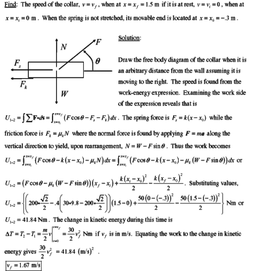

  • Handwritten solution to a work-energy problem: free body diagram of a collar on a rod showing forces F, F_s, F_k, N, W and angle theta, followed by the work integral and kinetic energy equations ending with v_f = 1.67 m/s.

It says spring length is 0.2 m. That's where the moveable end is (call it ##x_0##) when the spring is relaxed.
Whole sequence starts at 0.5 m (point A); when the moveable end of the spring is at A the spring is already stretched by 0.3 m.
So for the work calculation you start at ##x_i = 0.5##. Spring force is then already ##x_i - x_0##.
And the work calculation ends at ##x_f= 2##.

Oh ok! Why do they have their x0=0.3 as negative?
And it looks like they integrated from 0 to 1.5. I guess its the same difference. I feel like what you did makes more sense though. Why did they do 0 to 1.5?
0.5 m from the wall is taken as x = 0.
(I overlooked that, too, sorry). But, as you say, same difference :smile: as long as you indeed correctly write down the differences...
