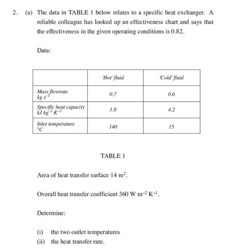

The data below relates to a specific heat exchanger. A reliable colleague has looked up an effectiveness chart and says that the effectiveness in the given operating conditions is 0.82.
For hot fluid: mass flowrate qm= 0.7 kg s -1, specific heat capacity cp=1.8 kJ kg-1 K-1, inlet temp= 140°C . For cold fluid: mass flowrate qm= 0.6 kg s -1, specific heat capacity cp=4.2 kJ kg-1 K-1, inlet temp= 15°C . Area of heat transfer surface=14m^2, Overall heat transfer coefficient 360 W m-2 K-1.
Determine:
i. the two outlet temperatures.
ii. the heat transfer rate.

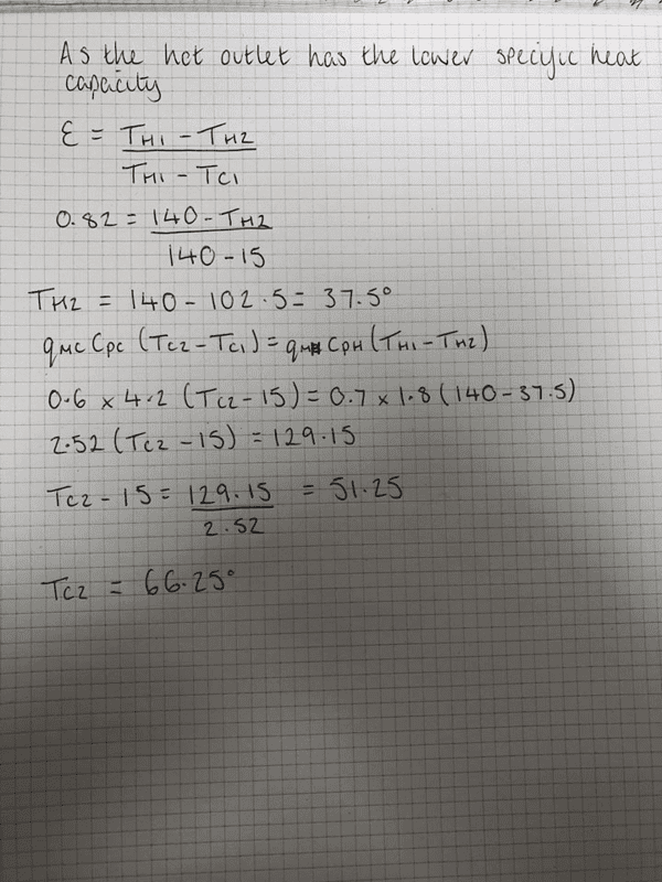

I've spent ages on this but can't seem to find an equation to find both outlet temperatures! Any help would be greatly appreciated.

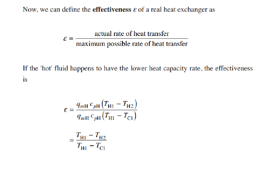

ε=(T_HI-T_H2)/(T_HI-T_C1 )
Because the specific heat capacity is lower for the hot fluid:
ε=(T_hi-T_h2)/(T_hi-T_C1 )
0.82=(140-T_h2)/(140-15)
140-T_h2= 102.5
T_h2= 140-102.5=37.5°
I'm not sure if I'm actually on the right track here, if I am this is as far as I've gotten. I can't seem to then find an equation to calculate T_c2 other than the equation which my lessons tell me is only used when the specific heat capacity is lower for the cold fluid.

This is where I'm currently at

PCal said:
In my lessons ε has been used to define effectiveness
My bad -- long time ago :sorry:
To make up: Got the same result as you did.
fab thank you!

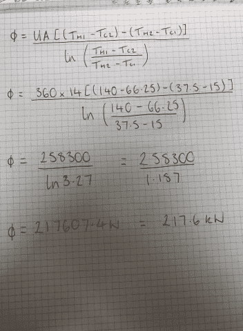

241404
one more thing, how's this for the heat transfer rate please?
Is this a countercurrent heat exchanger or a co-current heat exchanger? I assume that it is countercurrent, correct?
The question doesn't actually specify, I've assumed it's countercurrent/ cross flow
Part C of the question also refers to the correction factor which leads me to think it's cross flow
In #1 you calculated 129 kW
##Q_{\rm max} ## = 157.2, so I find 218 kW hard to believe ...
The 218 comes from UA*LMTD which applies to a countercurrent heat exchanger. Here you have a less effective heat transfer configuration, so a higher LMTD and your expression isn't valid.
Must say the exercise composer doesn't make it easy for you. Good you did the UA*LMTD check -- I did it too and had to look more than twice :wink:
Chestermiller said:
Must say the exercise composer doesn't make it easy for you. Good you did the UA*LMTD check -- I did it too and had to look more than twice :wink:Hi Chet! I was kind of struggling with that too. With ##\ C_{\rm min} =1.26,\ ## and ##\ UA =5.04##, NTU = 4. C_r=0.5 so that ##\ \varepsilon## for co-current would be 0.66 and counter 0.93 with the 0.82 in between.
Of course, I didn't click onto that! Does 129.5kW sound like a more believable heat transfer rate please? Apologies this modules taking a lot to get my head around!

Thank you, so using that I'd get a heat transfer rate of 129.15 kW? Given that, am I correct in thinking I'd then use ∆Tc=UA/Φ then F=∆Tc x LMTD to get the correction factor?

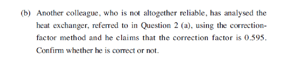

Sorry, the next part of the question asks...
241477
Would the equations I posted above prove this wrong please? I worked out that the correction factor=1.68 but have no idea if this is correct.
What is the reciprocal of 1.68?
0.59! Why have I had to take the reciprocal though?
Got it! I was doing F=∆Tc x LMTD as opposed to F=∆Tc/LMTD
Thank you for all your help!
