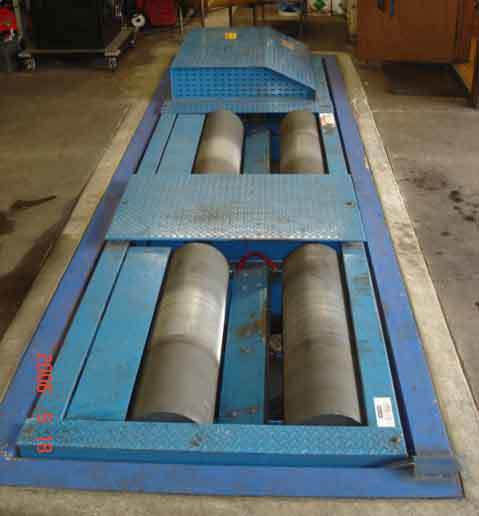

If you have a dyno available to you, that'll be easy...
Not sure what a dyno is, you mean this?
http://www.collingdaleperformance.com/home.html
