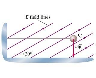

An object of mass m= 5.0g and charge Q= 45mC is attached to a string and placed in a uniform electric field that is inclined at an angle of 30.0 with the horizontal (see the figure). The object is in static equilibrium when the string is horizontal
Find the magnitude of the electric field in (N/C) and then find the tension in the string
I am not sure how to do this I think you would you the Coulombs equation kQ/r^2 but I do not know how to find r. Also I can not remember how to find tension
You won't need Coulomb's law--that tells you the force between two point charges, which is not what you have here. Instead, what's the most basic relationship between electric field, charge, and electric force?
Also: The fact that the mass is in equilibrium should tell you something about the net force on it. Hint: Consider vertical and horizontal force components.
