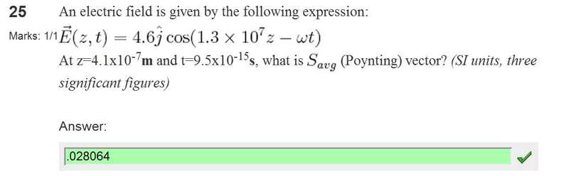

What is the formula for calculating average power of electromagnetic waves?
In summary, the conversation discusses the equation for Savg, which is equal to Em * Bm / (2*μ0 * c). The person asking the question solved for Savg without calculating inside the cosine, but still got the correct answer. The topic of discussion also includes the meaning of Savg, Em, and Bm, as well as the factors that determine the value of Savg.
blackbyron
48
Savg = Em * Bm / (2*μ0 * c)
I solved for S avg without calculating inside the cos, but I got it right.
The z and t is given, but is there the reason why you don't solve inside the cos, or is it the bug? it's makes me confused.
Thanks
What do Savg, Em and Bm mean?
ehild
I see, I look at my teacher's notes and saw the exact equation.
So to solve for Savg, it only cares about the maximum values right?
Right, the result is independent of frequency or position.
Thanks for your help.
