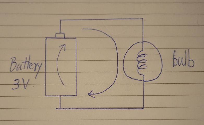

Suppose that you have a switch connected to the negative terminal of your power supply and ten meters of wire running from the switch to an incandescent light bulb. The other side of the light bulb has another ten meters of wire running back to the positive terminal of the power supply.
The switch is open for now. In effect, the "negative" wire is only connected on the light bulb end. It floats at the positive terminal's voltage.
Using the positive terminal of the power supply as our voltage reference, all of the electrons in the wire on the positive side are at 0 eV. All of the electrons in the wire on the negative side are also at 0 eV.
Close the switch.
Before any of the electrons have moved appreciably, the electrons already in the wire on the negative side are suddenly at 250 eV potential. It was not because a new batch came out of the power supply with 250 eV potential and filled up the wire, replacing those old tired 0 eV electrons. Instead, it was because the field in the wire changed to have a 250 V potential.This does not contradict what you are saying. But it does suggest that the model of electrons coming out of the negative terminal with potential energy and then losing it as they pass through the circuit misses something.
Or try looking at it from another angle. In the system in the image below, the electrons apparently gain 3eV of energy when passing through the battery and lose 3eV when passing through the light bulb.
