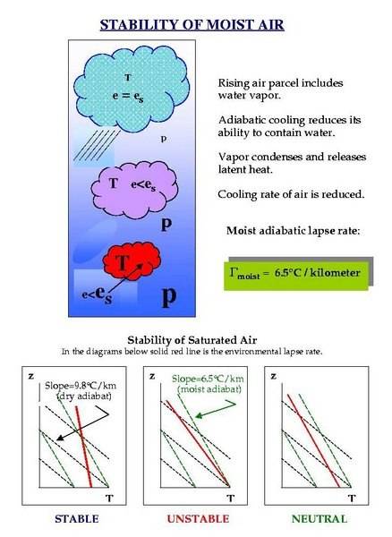

1. When water vapor in the free atmosphere condenses into either water or ice, the temperature of the remaining gaseous atmosphere increases.
I'm certainly no expert.
Dad was an aviation forecaster for US Weather Bureau
He taught me a couple basics.
To nitpick your #1
As you've worded it seems to me to imply heat flow from cold to warm,
Since there's no temperature change during a phase change
i'd say instead "condensation or freezing arrests cooling ..."
as evidenced by watching cumulus clouds grow vertically -
rising air wants to cool as it expands but condensing moisture keeps the air warm making a thermosiphon hence the columns one sees in summertime. Almost as if the expansion departs from adiabatic...
At night when air reaches the dew point by radiation cooling, dew must form before the air-water mix can cool further. Almost as if there's a discontinuity in specific heat...
Latent heat being the reason.
Pic from http://eesc.columbia.edu/courses/ees/climate/lectures/atm_phys.html
Sorry for the large pic size.

jim hardy said:
To nitpick your #1
I agree.
Thanks Don, i'd completely forgotten about "lapse rates"
And a picture is well worth a kiloword..
old jim
