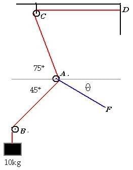

Determine the magnitude and direction (theta) of F in the diagram of
ΣFx = 0
ΣFy = 0
F = ma
I tried using the sum of components but I end up with three variables and two equations. I've always had issues with figuring out tension through a pulley system. I'm hoping for some insight as to what parts of the diagram are relevant to finding F.
So far I've figured F(ab) = cos45(98N) = 138.6N but I can't figure out how to relate that to F and Fac and Fcd.
is Fcd equal to ΣFy?
This is from my statics book and my physics text isn't helping either.
Any clues are appreciated, thanks.
Ok I think I got it. Someone else posted a similar problem that I didn't find before.
So tension is the same through the entire rope = 98N
Knowing that I found the x & y components of the two known angles, 45 and 75. These components have to combine with those of F to equal 0. Then I found they theta with these values.
I hope it is this simple...
