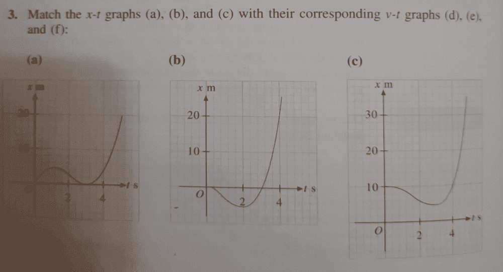

match the distance- time graphs to their corresponding velocity - time graphs
kinematics
now there is something i am not getting here, consider for instance graph ##a##,
analyzing this graph i can say as follows;
between time ##0≤ t<1, ## the velocity is increasing...
at time ##t=1##, also reffered to as being intantaneously at rest, at this point we have acceleration ##a=0##,
between time##1< t<3 ##, the velocity is decreasing...
at the point ##t=3##, we have ##a=0##,
between time ##3< t<5 ##,velocity is increasing...
is my analysis correct?
lets start with the graph a. Now if my analysis is correct, which corresponding graph will suffice?
i would expect that if velocity is increasing between time ##0≤ t<1,## then acceleration should equally be increasing, and i cannot see which graph reflects that...

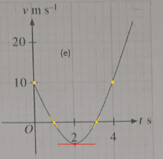

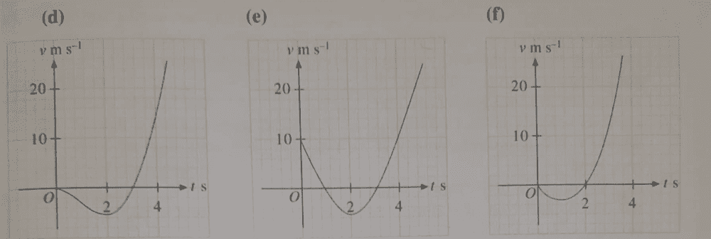

consider the velocity time graph ##e##, at time ##t=0## and ##t=1## the graph at this points are represented by a straight line, therefore the distance traveled between these two points, ##x= 0.5 ×1×10= 5m## which corresponds only with distance- time graph ##(a)## having co ordinates ##(x,t)=(1,5)##.
am i right? therefore for this case, ##a→e##
Note textbook answer are ##[a→e, b→f, c→d]##
Dear Chwala,
This is an exercise in differentiation and integration, both very important for physics.
Differentiation
You know that the rate of change in position is the velocity: ##v = \displaystyle {\Delta x\over \Delta t} ##
When things change continuously, this becomes a differential (instantaneous velocity):$$v(t) ={dx(t)\over dt}$$
This brings you from graphs of ##\ x(t)\ ## to graphs of ##\ v(t)\ ## because ##\ \displaystyle {dx(t)\over dt} ## is the slope of the ##x(t)## graph at time ##t##. You take a transparent ruler and look for tangents.

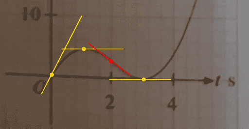

For example in figure a) the interesting ones are:
(sorry for the quality :wink: )
  • at ##t=0## the yellow line with a slope of 10 m/s.
  • at ##t=1## and ##t=3## the orange lines with slope 0 ##\Rightarrow\ v(t)=0## m/s.
  • and, finally and very interesting: at ##t=2## you have an inflexion point wth slope -1 m/s.
Inflection points are very helpful: at such a point the curve changes from convex to concave (or vice versa), so the slope is at a minimum (or maximum).​
With these four characterizing points it is very easy to pick the right ##\ v(t)\ ## graph !Integration
From $$v(t) ={dx(t)\over dt}$$ we go to (mathematicians won't like this, but we do :smile: it without hesitation) $$
v \Delta t =\Delta x\quad\Rightarrow\quad dx(t) = v(t) dt \quad\Rightarrow\quad x-x_0 = \int dx(t) =\int v(t) dt$$And this brings you from graphs of ##v(t)## to graphs of ##x(t)##.
The dotted items for integration in reverse: [edit:sorry, mistake in first edition :frown: ]
The dotted items used for differentiation we reverse for integration :
  • the y-axis crosssings give you extrema: ##v(t) = ## zero
  • Extrema give you inflexion points
What you don't get is ##x_0## : the constant of integration can not be found from the integrand ##v(t)##.​
So in that respect integration deserves a bit more attention than differentiation. You may need to draw a line with a given slope but unknown intercept at some point(s). The most logical candidate is at ##t=0##.
As an example I could do this for figure e) but by now we know where that leads us, don't we ?

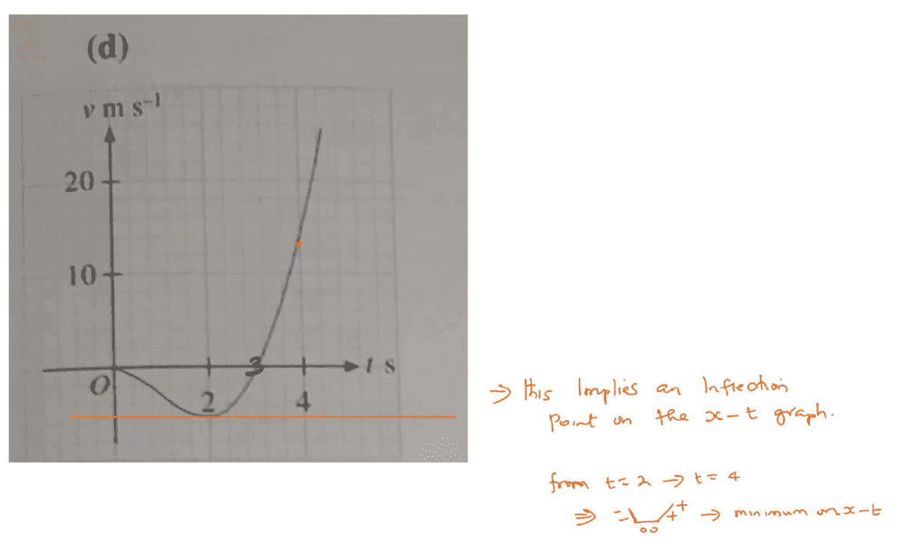

Instead, why don't you try figure d) in this manner to see if I have actually been helpful in this.
(It is a great pity you already have the answers, it distorts unbiased thinking).##\ ##

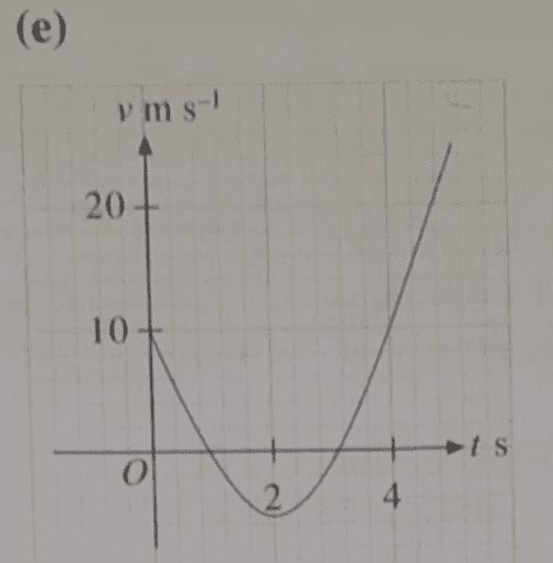

so if we consider graph 3.e, by considering a straight line ...passing through the points ##(0,0)## and ##(0.8,2)## , we shall have,
##x=∫2.5t dt= 1.25t^2+k##

i want to understand the graph 3.e ...ok i want to get this right, so in integration i should be using the constant derivative to get the straight section(distance function) right? by considering the points ##(0,0)## and ##(0.8,2)## i am getting a gradient of ##2.5##, is this correct...therefore is this the value that i am integrating?

Remember that you want to integrate the graph of ##v(t)##.

I do not see the point ##(0,0)## lying on the graph ! Nor the point ##(0.8, 2)## !
ok btwn ##t=0## and ##t=1##, we shall have,
##v=∫-10 dt= -10t +k## applying the conditions, ##(0,10)##,
we have ##v=-10t +10##
therefore, ##x=∫vdt=\int_0^1[-10t+10]\,dt=5m##
I tried to make clear to you that you can not obtain ##x_0## from a ##v(t)## plot, because constants disappear when differentiating. So the best you can get is ##\Delta x##.
You now treat the first second of (e) as a straight line, which is ok, but clearly an approximation.
o:) [edit sorry: ##x = 0## does not mean crosssing the y-axis --- Why not start with finding the y-axis crossings]
Why not start with finding the time-axis crossings of the ##v(t)## plot -- they provide the moments when the plot of ##x(t)## is horizontal. Namely at ##t-1## s and ##t= 3## s (orange points in the picture below).
At ##t=1## s ##v ## changes from positive (forward) to negative (backward), so that is a maximum in the ##x(t)## plot.
At ##t=3## s (a little more actually), ##v ## changes from negative (backward) to positive (forward), which means that's a minimum in the ##x(t)## plot.
Then the next easy one is the minimum in ##v(t)## at ##t = 2## s (red) : an inflexion point in the ##x(t)## plot.
If these three are not enough to identify the corresponding ##x(t)## plot, you can still make a decisive distinction with the ##v(0) = 10## (left yellow point)which is the slope of the ##x(t)## plot at ##t=0##, thereby discarding possibilities (b) and (c)
Any questions :smile: ?
If not, can you analyse picture (f) ?

yep, let me analyse graph##f## with the y- crossings...i will check on this later in the day and post back...cheers

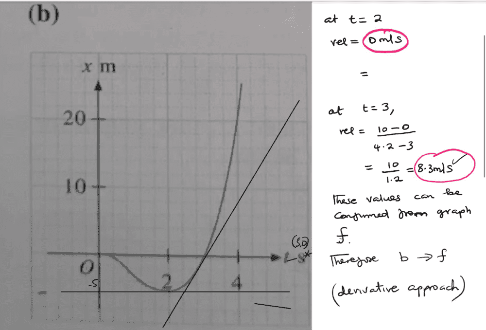

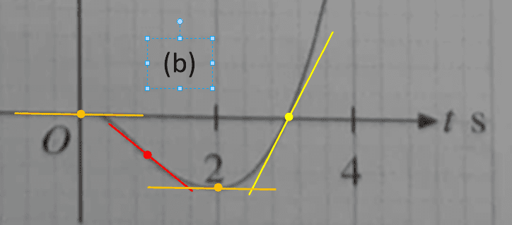

i have used the derivative approach of drawing tangents...and clearly i can see that this graph ##b## will correspond to the ##v-t## graph## f##.
In this ##x-t## graph, kindly note that we are not able to draw tangents at value ##t=1##

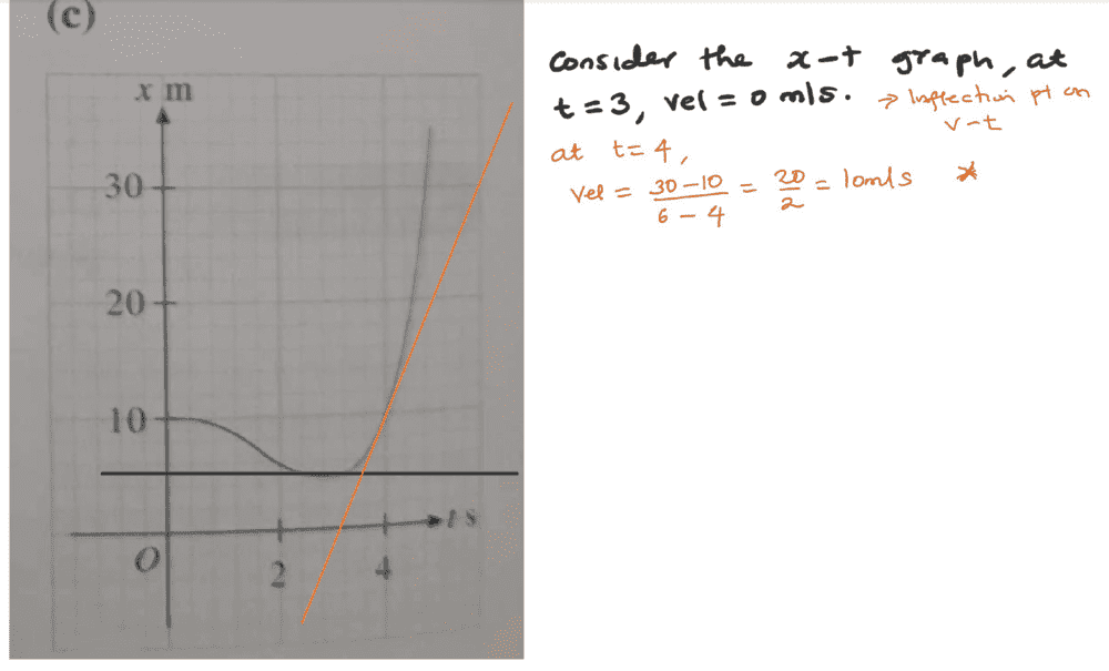

if correct i will proceed to graph ##c## then use the reverse method ##v(t)=0## to match graphs ##e## and ##f## back to their corresponding ##x-t## graphs...
Well done !
I would draw the tangent at ##t=3## in (b) a little steeper :wink: :
In (f) you also have ##\ v=0\ ## at ##\ t=0\ ##, so the ##\ x(t)\ ## plot must take off horizontally. However, this does not help to distinguish between (b) and (c) , because both start the same way.
Furthermore: on (f) at ##t=1## you can conclude there must be an inflexion point in the ##x(t) \ ## graph. This does distinguish between (b) and (c) .
chwala said:
if correct i will proceed to graph c then use the reverse method ##\ v(t)=0\ ## to match graphs e and f back to their corresponding ##\ x−t \ ## graphs...
Excellent plan !
BvU said:
Well done !
Excellent plan !
Thank you Bvu, i have learned a new concept here...
So what's the story with (c) ?

this is what i came up with...
1. Considering the ##x−t## graph, at ##t=3,## velocity =##0m/s## agreeing with the ##v−t## graph.
2. I also tried drawing a tangent line on the ##x-t##graph at the point ##t=4##, ...there is a problem here, the values are not in sync...i am getting ##v(t)=10m/s## but correct value is ##v(t)=14m/s##
3. Analyzing the v−t graph, we have a stationary point at ##t=2## which implies an inflection on the ##x−t## graph
4. At the point ##t=2## to ##t=4## on the ##v-t## graph the graph changes from negative to positive, this implies a minimum point on the ##x−t## graph.
Chwala said:
1. Considering the ##x−t## graph, at ##t=3,## velocity =##0## m/s, agreeing with the ##v−t## graph.
I agree. ##v=0## is therefore a point where ##v=0##, NOT an inflection point on ##v(t)##! Nor on ##x(t)##.
(I see I misspelled inflection a few times -- so I learn from this thread too !)​
No reason for worry - the difference between ##\arctan 14## and ##\arctan 10## is only 2% .​
Excellent !
To be precise: at ##t=3##. Very good too !

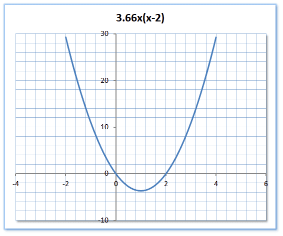

I think we have milked out the graphical stuff quite well and quite satisfactory by now. So I want to do something in another direction. Usually I tell posters to make a sketch if all I see is symbols and equations. This time it's all graphs and now I have a small challenge:
The graph (f) looks suspiciously like a plot of ##v(t) = 3.66 \,t \, (t-2) ##:
So can you -- analytically -- tell me the equation for ##x(t) \ ## ?

kindly clarify, i think you meant "find the equation for ##v(t)##"...as you had indicated earlier we cannot find ##x(t)##...as we do not have initial conditions...
let ##v=at^2-2at##
the turning point is at the point ##(1, -3)##,
therefore,
##-3=a-2a##
##→a=3##
therefore, ##v(t)=3t^2-6t##

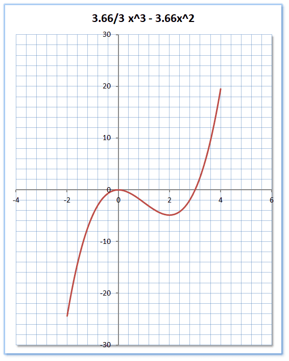

No, I really meant
Find the equation for ##\ x(t)\ ##, given that the equation for ##\ v(t) \ ## is $$v(t) = 3.66 \,t \, (t-2) \ .$$As you correctly observe, you need one initial condition. Let that be ##\ x(0) = x_0\ ## with ##\ x_0 = 0 ## m.
