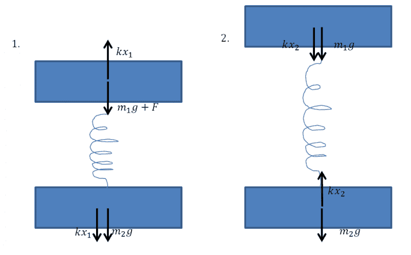

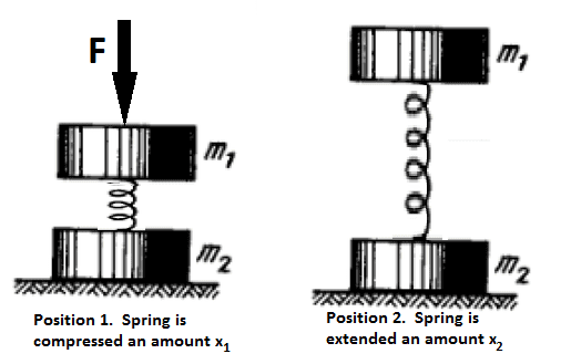

There are two different values of ##x## that you need to work with: ##x_1## and ##x_2##. See the picture below. (##x## changes as you go from position 1 to position 2 and so the spring force changes as you go from position 1 to position 2.) In position 1, ##x_1## is related to ##F## by the fact that the net force on ##m_1## is zero in this position. In position 2, ##x_2## is related to ##m_2## by the fact that the spring is just about to lift ##m_2## off the floor.
You should be able to obtain a formula for position 1 relating ##x_1## to ##F## and a formula for position 2 relating ##x_2## and ##m_2##. These formulas are essentially your equations in the OP except that you need to use the symbols ##x_1## or ##x_2## when writing the formulas.
These are the equations:
##F+m_1g=kx_1##
##kx_2=m_2g##
How can these equations help me?
The second equation essentially tells you the value of ##x_2##. So, you can consider ##x_2## as known. The first equation let's you find the answer for ##F## if you can find the value for ##x_1##.
If you can find an equation that relates ##x_1## and ##x_2##, then you could solve for ##x_1##. Can you think of a conservation law that applies to the system as it moves from position 1 to position 2?
I fail to relate ##x_1## and ##x_2##. Is it correct to say that ##kx_2-m_1g=m_2g##?

The only relationship between ##x_1## and ##x_2## I can make is this:
When ##F## disappears, ##m_1## starts to move upwards with net force, which is equal to ##kx_1−m_1g=(F+m_1g)−m_1g=F##. Only this force makes the string to expand, so obviously this force creates ##kx_2## or in other words ##F=kx_2##. I really don't understand what is wrong with this reasoning. Why should I avoid ##F##?
OK. This is correct.
Only this force makes the string to expand, so obviously this force creates ##kx_2## or in other words ##F=kx_2## . I really don't understand what is wrong with this reasoning
As soon as ##m_1## starts moving up, the net force will of course decrease. But you are right that the net force acting on ##m_1## at the instant just after F is removed is equal in value to F. I'm not sure what you mean when you say that "obviously this force creates ##kx_2##". Anyway, it is not true that ##kx_2## has the value F. However, you might be close to the right result. Can you find an argument for showing that the net force on ##m_1## when it is at ##x_1## is the same as the net force on ##m_1## when it arrives at ##x_2##? Note that the net force on ##m_1## when it arrives at ##x_2## is not ##kx_2##.
Using F is fine. But it should always refer to the value of the applied force that held ##m_1## down before ##m_1## was released. In some of your earlier posts it appeared to me that you might have been using F for a spring force. But I could have been misinterpreting what you wrote.
  • #31
Well, I think the upward net force acting on ##m_1## in position ##x_1## is the same force which creates a downward net force in position ##x_2##, so maybe this applies:
##kx_1-m_1g+F=kx_2+m_1g##
Then I used these equations:
kaspis245 said:
##F+m_1g=kx_1##
##kx_2=m_2g##
And got ##F=\frac{g(m_1+m_2)}{2}##.
Does this happen to be the correct answer?
  • #32
The left side should represent the upward net force at ##x_1## after the applied force F is removed.
  • #33
Sorry, ##kx_1-m_1g-F=kx_2+m_1g##. Now I see that it gets me nowhere...
  • #34
You still don't have the left side correct. There are only two forces that act on ##m_1## after F is removed.
  • #35
Sorry again: ##kx_1-m_1g=kx_2+m_1g##.
  • #36
OK. This gives you a third equation that you can use along with your two equations from post #25.
  • #37
I get the answer ##F=g(m_1+m_2)##. Is it correct?
  • #38
Yes. I believe that's the answer. The only thing lacking is a justification for why you can claim that the net force on ##m_1## at ##x_1## (after F is removed) is equal to the net force at ##x_2##.
