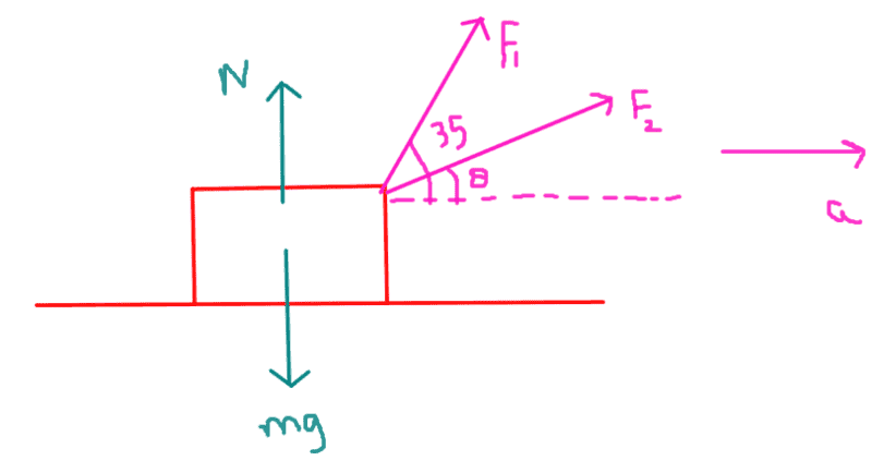

Ok, let me put a free body diagram, otherwise we will be talking past each other. Is that FBD correct ?
  • Free-body diagram of a block on a horizontal surface with normal force N up and weight mg down, two applied forces F1 and F2 at the top-right corner, F1 at 35 degrees above the dashed horizontal and F2 at angle theta, and an arrow labelled a pointing right.

No. You have drawn vertical force components. There are no vertical force components apart from the gravitation and the normal force.
Orodruin, are you saying that both the forces are acting along the positive x direction ? Then what is 35 degrees referring to ?

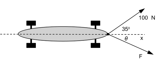

The problem didn't say that explicitly, didn't say whether those angles are vertical angles or horizontal ones. But for the reasons you gave, the problem doesn't make sense if they are vertical angles. As I said in my initial response, the problem only makes sense if all the forces and angles are in the horizontal plane.
Orodruin is completely right. If we are to solve this confusion, we must realize that:
1. There are three directions, which I will call here, x, y (both in the horizontal plane) and the vertical direction, which we can call z.
2. The original statement of the problem does not make point 1 clear, which is the driving force behind the confusion.
3. The problem can be solved if we follow what Orodruin is saying. Both forces are in the horizontal plane. The angles given are therefore angles in the horizontal plane. N = mg will then be correct, but irrelevant to the problem because both N and mg are along the vertical (z) direction.

Let me try. Picture a coordinate system with all three axes x, y, and z. X points east, y points north, and z points up. What Orodruin is trying to tell you is that the problem is in the x y plane. There is no up. The angle refers to the angle from the x axis. Mom is pulling North of east. In order for the boy to move East Dad must pull south of east. The two dimensions give you two equations and so you can solve for both the magnitude and direction of Dad’s force.
Regarding N=mg, that does not act in the x y plane. Also skateboard = “no friction”, so all you have are mom’s and dad’s forces and inertia.
