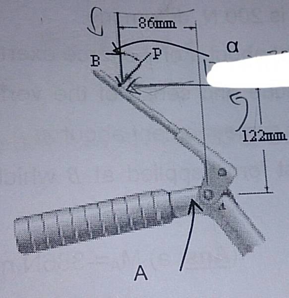

i have question with part B
my working is
13.2 cos tetha (0.86x10^-3)+ 13.2 sin tetha (1.22x10^-3) = 1.95
i gt stucked here. how to proceed? i only have one equation , how to solve two unknown ?

You should not assume the moment is 1.95 for part A. From the given information you should be able to see that theta is 30o, which enables you to calculate the moment of P about A for question a.
i have done part A , i just have problem with part b , i did not assume the moment is 1.95 for part A. i gt -1.788N for part a

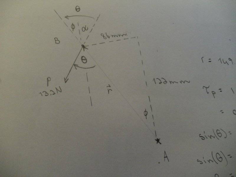

Another way is to use the formula τ = P r sin(θ) where θ is the angle between P and r. You need to make a drawing to figure our what the relationship between θ and α is then.

(13.2cos (alpha) ) ( surd(0.086² +0.122² ) )= 1.95 , alpha = 8.23 degree , still wrong !
Did you take the square root to obtain r? The angle in the equation is not necessarily alpha. Make a drawing to discover the relationship.

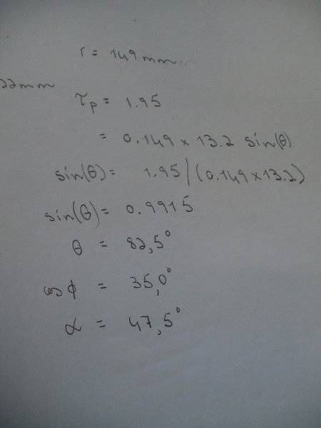

I seem to get 47.5o for α
Unfortunately the arc sin function gets very steep near 1, so it's hard to get enough precision. I get more like 46.6 or 63 degrees.
