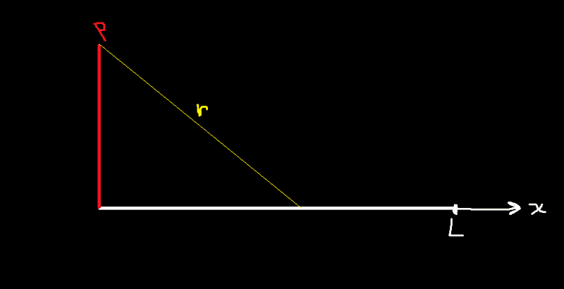

If I'm trying to find the voltage at point P due to a linear charge density of length L (the white line that lies on the x axis):
then how come it is incorrect to do the following?
$$V=\int{\vec{E_{x}}dx}+\int{\vec{E_{z}}dz}$$?
(the r vector is just to find dE at each point on the charge density of length L)
Hello I,
What exactly does your equation mean ? Ex ? Ez ? what is dx, dz and what are the integration bounds ?
Also: is your endering of the exercise complete ? r ?
$$\vec{E_{x}}$$ and $$\vec{E_{z}}$$ are the electric field vectors in the specified directions, x, and z respectively.
I'm not concerned with specific bounds at this time right now i am only concerned with whether or not i have the right expression for potential at some point in space i decided to call "P".
i don't know what you mean
r?
"(the r vector is just to find dE at each point on the charge density of length L)"
You want to find the potential at point P due to the line charge on the x-axis.
If you already, at all points in space, know the electric field, cause by the line charge, then you can integrate, e.g. Ez dz from z =∞ to z = z(P) to get V.
Or Ex dx from x =-∞, z = z(P) to x = 0, z = z(P)
These two under the assumption that V = 0 far away from the wire (which x = ∞, z = z(P) does not satisfy).
They look like your integrals, only one has dx = 0 and the other dz = 0 (makes life easier).
My question about the Rendering (sorry) of the original problem was inspired by the fact that I am missing an indication of what z is, what r is, whether the charge density on the line is a constant, ...
Since you don't work out your integrals, I am inclined to believe you do not have an expression for ##\vec E(x,z)## for all ##x,z##. You could embark on finding one, but the exercise only asks for the potential.
I take it you do have an expression for V as a function of q and r at hand. So if you chop your line charge into little pieces with length dx, each little piece having a charge ##dq = \lambda dx## and contributing a little ##dV = ... dq = ... dx##, I am sure you can easily write down an integral that finds you V diectly!
