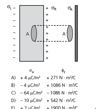

In summary, the problem involves an infinite metal plate with a surface density of charge -6μC/m² on the left side and +4μC/m² on the right side. A circular cylinder Gaussian surface is placed with the left side inside the plate and a thin plate loaded on the right. The problem is to find the correct option for the surface charge density σA and the electric flux ΦE through the Gaussian surface. By using Gauss's Law and taking into account the field inside a conductor, we can find the equation for the electric field inside the thick plate and solve for the density and flux.

An infinite metal plate has a surface density of charge σL=-6μC/m² , Left side and a surface density Of load σR=+4μC/m² , in the right side. A Gaussian surface In the form of a circular cylinder, with area A 12 cm², is Located with the left side inside the plaque and a thin Plate loaded to the right. The surface charge density of the Metal plate is σA. Check the correct option with respect to the density value Superficial σA And flow ΦE Through the Gaussian.
ANSWER: D
Gauss law for an infinite plate: E=|σ|/2ε0
I could not understand the problem, I do not know how to find the density and nor the flow. I tried to use Gauss's Law but I could not understand the problem.

Can you be more specific about what it is that you do not understand?
You have a charged thick metal plate and a charged thin metal plate. Since the thick plate is a conductor, what can you say about the field inside it?
You quote the formula for the field resulting from an infinite uniform plane of charge. What fields from such planes act inside the thick plate? What equation does that give you?
What is Gauss' Law?
