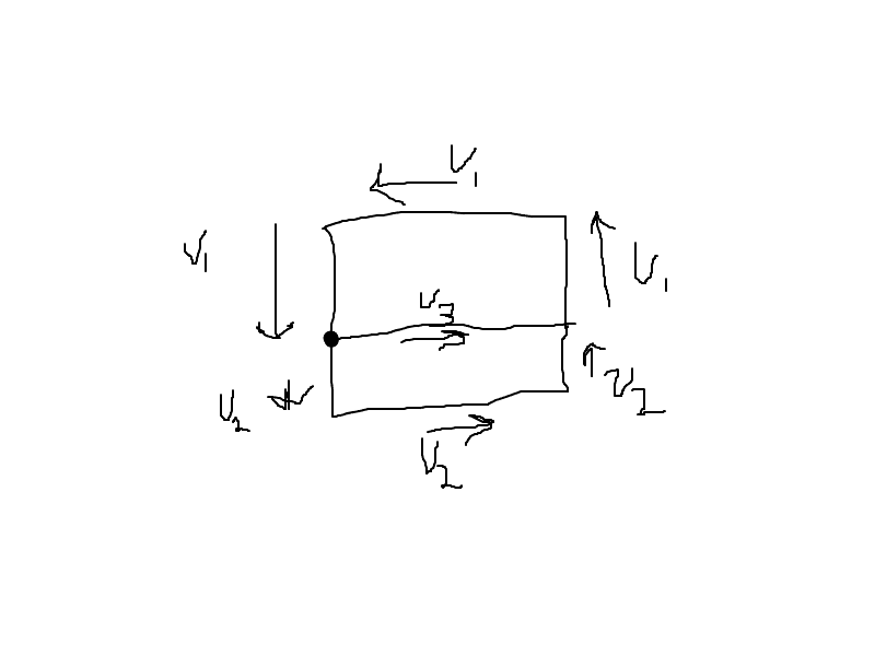

3) Find current through each resistor. Give magnitude and direction of current flow.
Kind of lost on this one. I have a feeling I need to do kirchhoffs rule. How would I handle the battery in the center? I only have examples with the center having a resistor to go off from. The flow was also specified for me. How would I determine the flow if I am not given that information? :(
So far I took the loop counter clockwise from positive end for the top part and current heading towards the right in the center.
12V-3I(1) -6I(2) + 3V= 15V -3I(1)-6I(2) = 0
Bottom counter clockwise from negative end.
-6V-2I(3) +6I(2) -3V = 0
-9V - 2I(3)+6I(2)=0
Look anywhere right so far?

For circuit 3, the voltage will be equal across all items in the circuit. It is the current through each item which changes.
You will have i1, i2 and i3. Where i1 = i2 + i3.
i1 = Vtotal / R1
and so on for the whole circuit.
You need to analyse this circuit using Kirchoff’s Second Rule (loop rule).
Would the V total be 3?
12 opposed by the 3 and 6 , 12-3-6= 3
V=IR
3=3I
I=1 across top resistor
I(2) + I(3) = 1
Would the I(1)=I(2)+I(3) look something like this?
Got pulled away from computer, working on this now. If you happen to see is this, was this what you were trying to say?
In a parallel circuit the voltage is the same across it. So no matter which resistor you measure the voltage across you will read the same value.
It is the current which will vary around the circuit.
In your diagram above, instead of V you should have I, aside from that it is correct.
V1 in your diagram = V2 + V3 But remember, this is current not voltage (again, should be I not V).

Yeah I got in a hurry copying from paper to paint and meant the V to be I.
