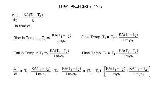

Two bodies of masses m1 and m2 and specific heat capacities s1and s2 are connected by a rod of length L crossectional area A,thermal conductivty K and negligible heat capacity.The whole system is thermally insulated.At time t=0 the temperature of the first body is T1and the temperature of second body is T2(T2>T1).Find the temp. difference betw. 2 bodies at time t.

The rate of heat transfer, given by H=kA*delta-T/delta-x, is equal to mc*dT/dt for both objects connected by the rod, only one rod's temperature goes down while the other's goes up. Depending on whether your class is calculus-based, you can either calculate the power transferred in time t and set it equal to mc*delta-T for both objects, or you can use calculus to get a more accurate solution.
actually i did lik this(see the attachment)
firstly is it correct
secondly wen i tried integrating it its not giving the ans.

im getting ans as (T2-T1)e(1-f)t
wer f=KA(m1s1+m2s2)/(L(m1s1m2s2))
wer as ans is (T2-T1)e-ft
