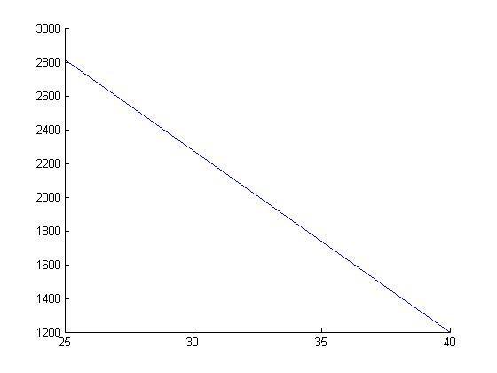

Hey, thanks for the reply. I am only interested in temperatures between 25 and 40 degrees. Is there a way to do it without an op-amp as I only have a microcontroller with an 8 bit ADC. I have just plotted the linear approximation in matlab, I have uploaded the file.
edit: the thermistor is only dependent of the temperature.
What do you mean you only have an ADC? Does it already include the sample-and-hold circuit that feeds into most ADCs? Or is it on the uC itself?
To do the offset, you will need to have a negative supply available. Do you have that?
If you don't need full 8-bit resolution, you can just bias it with a resistor that gives you 2.55V when the thermistor is max resistance, and do the offset in your uC.

The ADC includes a sample-and-hold circuit and I do have a negative supply available.
I don't understand what you mean by this...
