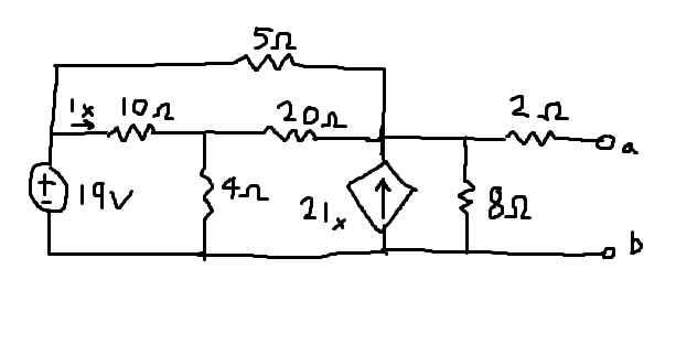

a load resistor = 25ohm connecting A and B
trying to find V(th) first...any help would be appreciated.
Mesh 1: 14I1-10I2-4I3=19
Mesh 2: -10I1+35I2-20I3=0
Supermesh: -4I1-20I2+24I3+8I4=0
Aux. 1: I(x)=I1-I2
Aux. 2: 2I(x)=I4-I3

asdf12312 said:
not sure if i did it right..that's what. i mean the equations for the meshes. is the dependent current source only shared by two meshes? because it seems that the mesh at the top also shares that source. so should all 3 be a supermesh ??
The current source is only shared by I3 and I4. It isn't in the I2 mesh.
OK, so I didn't feel like doing much work with that matrix so i just plugged in the numbers into a determinant calculator http://www.bluebit.gr/matrix-calculator/
I got 1.20A for I(x), and 2.186A for I4. actually I4 is all I need to solve for V(th), i believe.
V(th)=2.186A*8ohm=17.5V
did i do this rite?
Yes, you've got Vth correct.

i actually already calculated I(sc). I just wanted to find I(x) cause it seemed important with the dependent current source and all. i actually decided to use a 4x4 matrix instead of the 5x5 one you had (seemed..larger). used this to find V(th).
Code:
[ 14 -10  -4   0]  [I1]  =  [19]
[-10  35 -20   0]  [I2]  =  [ 0]
[ -4 -20  24   8]  [I3]  =  [ 0]
[  2  -2   1  -1]  [I4]  =  [ 0]
and to find I(sc)=I(th), i just added another mesh, and edited mesh #3 equation. now i had a 5x5 matrix like you had. could've still simplified it into a 4x4, didn't feel the need though.
Code:
[ 14 -10  -4   0  0]  [I1]  =  [19]
[-10  35 -20   0  0]  [I2]  =  [ 0]
[ -4 -20  24   8 -8]  [I3]  =  [ 0]
[  0   0   0  -8 10]  [I4]  =  [ 0]
[  2  -2   1  -1  0]  [I5]  =  [ 0]
and yep, got the same value as you. I(sc)=I(th)=3.853A. thanks!

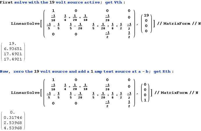

You could also have solved for both Vth and Rth directly by using nodal analysis. Here's how that would work:
