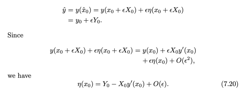

Why Does Taylor's Theorem Use +O(ε) Instead of -O(ε)?
gionole
281
24
Help me with taylor's theorem
I am trying to grasp how the last equation is derived. I understand everything, but the only thing problematic is why in the end, it's ##+O(\epsilon)## and not ##-O(\epsilon)##. It will be easier to directly attach the image, so please, see image attached.
I am not accustomed the way of the text. What is the text you use ?
O-notation tells you about the magnitude of the error in some limit, in this case \epsilon \to 0; the sign of the error can depend on \epsilon, so it is conventional to use a plus sign.
The expression, ##f=g+O(\epsilon)## means that there exists such positive number ##M## that ##|f-g| \leq M|\epsilon|##.
OTOH, ##f=g-O(\epsilon)## means ##g=f+O(\epsilon)##, which means that there exists such positive number ##M## that ##|g-f| \leq M|\epsilon|##. This is the same as above. So, one can always use ##+O(\epsilon)##.
