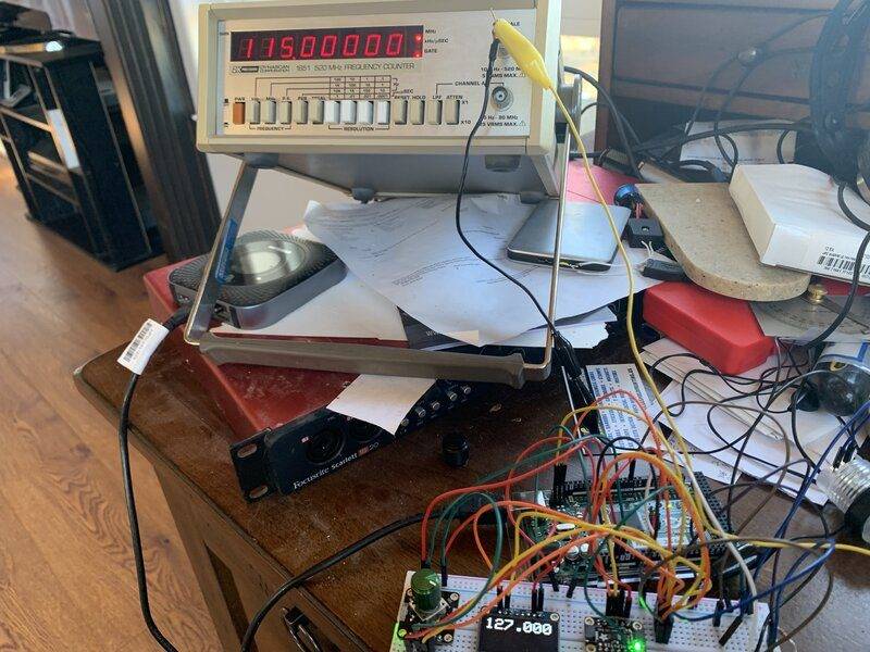

Yes, I’m using the Si5351 chip for that
  • #37
…and it works beautifully!

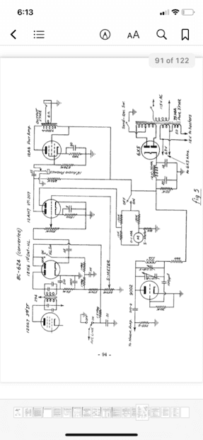

My receiver has been somewhat modified, using some of the ideas from the BC-624-AM and BC-624-C circuits. I wasn’t sure how much of this had been implemented in my radio but I spent the last two days going over it and it appears to match the mods published for HAM conversion many years ago. Here is a schematic showing the mods. I’m not sure how this might affect using the AVC voltage for tuning.
We need some way to prevent the forum corrupting schematics.
Maybe you could email me the original diagram as an attachment, or provide a link to the web discussion with the diagram.

piepermd said:
Can I just use a pair of resistors as a voltage divider to decrease the voltage for input to the microprocessor pin?
Now I see the circuit, the 250k S-meter pot, used I assume to adjust FSD of the S-meter, is such a divider chain and the voltage on the wiper contact will be at the lower end of the voltage range. Check out that wiper voltage with an oscilloscope. The S-meter is connected to the VT-207 plate circuit and the +HT supply, which is not good for A-D converters.
I am not yet sure how the AVC on/off switch works, or what sets the time constant. I will look at that in 8 hours when I get back.
Usually the AGC will be automatic when listening to several different transmitters, but when listening to only one, the AGC voltage is set with an RF gain pot, so the detected voice is clear, and the background noise does not rise to fill the quiet gaps in speech.
  • #58
The top of the 250k S_METER pot is the source of AVC voltage, negative-going with increasing signal strength.
The AVC voltage is tapped off thru the resistor going to the left of that junction. The AVC time constant appears to be 15ms, if i'm reading the blurry values correctly of 1.5Meg and 0.01uF.
The switch above those two components switches the AVC line to ground (OFF) to disable AVC, and to the 15ms RC filter (ON) to enable AVC.
The left half of the dual diode tube, 12H6, is the AM detector, the right half is the Noise Limiter, whose threshold varies with received signal strength.

piepermd said:
For the AVC voltage, do I probe between the S-meter adjustment pot wiper and chassis ground?
The S-meter circuit is difficult to model in that loop. The 12AH7 looks like it does a square-law conversion for the S-meter scale only, with the wiper used to calibrate the meter FSD. No matter how the S-meter components are adjusted, or change over time, the AVC voltage will remain a steady indication of the signal strength, so measure the voltage on the AVC line with a high impedance voltmeter.
  • #69
That’s easy, because the AVC line goes right out to the Cinch-Jones connector pin.
  • #70
And it is hard, because you need a very high impedance voltmeter.
The AVC line is driven through a low-pass filter that employs a 1M0 series resistor.
A digital voltmeter, with a typically 10M0 input resistance, will only read 10/11 = 91% of the actual voltage from ground.
You must compute the actual voltage by multiplying the meter reading by 11/10 = 1.100, and then maybe re-measure the AVC voltage relative to a low impedance voltage closer to the computed value, (maybe from a 10k pot). You are looking to make a zero current, null voltage measurement, then measure the low impedance reference voltage you used.
The AVC high resistance will have implications to the design of the circuit you employ to condition and convert the AVC voltage to the A to D converter input range.
