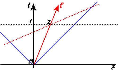

I should probably start by saying that I'm not too interested in the mathematics yet, I'm after conceptual understanding. I'll get the maths easy when I've got the concepts.
ok, this is what I've got so far, stop me when i get it wrong...
the black lines represent the inertial coordinate system (one time and one spatial axis) of an observer, who is passed at t=0 by another inertial observer (red line) traveling at velocity V wrt the coordinates. at the same instance, two photons are emmitted from the origin. these are the blue lines (c = 1).
since both observers were present at the event, both observers see the photons an equal distance from their own location, hence the dotted lines which represent constant time for each respective (colour coded) observer. (obviously the red line is parralell to the x' axis not shown) this is simultineity fallen out of the window.
its also pretty easy to get length contraction, as any distance along the x' axis will be shorter when projected onto the x axis, though I'm not sure that this is the correct understanding as it puts a limit on the contraction (1/root2 of the original length)
time dilation is however just confusing me. i can see that the "stationary" observer measures time along the vertical t axis, but is it right to say that the primed observer measures time along the t' axis? that means between 0 and 2 on the diagram the primed observer (according to the non primed observer) has experienced more time than the non primed. it looks to me like (again according to the non primed observer) the red line is longer, and a clock following this path will have ticked more often than the black line clock.
this doesn't fit what I've read so far about time dilation, so where am i going wrong? can I even use this diagram to explain time dilation?
thanks very much.

The dashed t and x axes have to be calibrated to get the actual values. Many textbooks on SR will show you how to do this using parabolas. Unfortunately I do mnot have the drawing skills to show you how. But, very roughly, to give the idea, if you draw the upper half of a parabola, cutting the t axis perpendicularly at a distance 1 along the t axis, then the point at which the t dashed axis cuts this parabola represents a distance of 1 along the t dashed axis.

You can't get time dilation just by looking at the geometric distance along the t' axis between two events in the diagram, no. Likewise you can't get length contraction by looking at the geometric length of an interval on the x' axis when projected on the x axis. If you take two events along the t' axis, and the distance between them in the unprimed frame is [tex]\Delta x[/tex] while the time between them in the unprimed frame is [tex]\Delta t[/tex], then obviously the geometric length along the t' axis between them would be given by the Pythagorean formula, so it'd be [tex]\sqrt{\Delta t^2 + \Delta x^2}[/tex]. However, to find the actual time between these events in SR, you have to use something similar spacetime interval which differs from the Pythagorean formula by a minus sign--it would be [tex]\sqrt{\Delta t^2 - (1/c^2)*\Delta x^2}[/tex] (normally the spacetime interval is designed to give something with units of distance rather than time, so it would normally be written as [tex]\sqrt{\Delta x^2 - c^2 \Delta t^2}[/tex], but this will differ from the formula above only by a constant imaginary factor). If you actually draw in the ticks of time and distance along the x' and t' axis, they appear stretched by the same amount when drawn in the context of the x and t coordinate system.
There's a further complication that the two lengths being compared in the length contraction equation are not directly analogous to the two times being compared in the time dilation equation--in the time dilation equation you're looking at the time interval between a single pair of events in both frames, while in the length contraction equation you're looking at the distance between two parallel worldlines along a surface of constant time in both frames (i.e. you're measuring the distance between the front and back end of an object at a single moment). Below you can see a diagram I drew up for another thread you might find helpful (click it to enlarge if it appears small)--you can ignore the stuff about the "temporal analogue of length contraction" and the "spatial analogue of time dilation" if you find it confusing, they are just meant to show that you could come up with a pair of spatial quantities more directly analogous to time dilation (i.e finding the distance in both frames between a single pair of events) and vice versa.

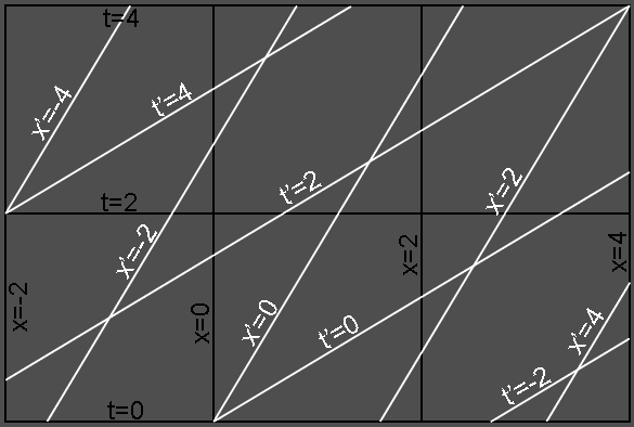

ok cool i get that, it explains why the axis are stretched. but is there any reason why that must be the case? oh and this might be a stupid question, but is there only one parabola shape? (ie, only one possible line which cuts through t=1 and converges on the blue line) my intuition says yes. actually isn't there a function? sinh or cosh or something.
You can't get time dilation just by looking at the geometric distance along the t' axis between two events in the diagram, no. Likewise you can't get length contraction by looking at the geometric length of an interval on the x' axis when projected on the x axis. If you take two events along the t' axis, and the distance between them in the unprimed frame is LaTeX Code: \\Delta x while the time between them in the unprimed frame is LaTeX Code: \\Delta t , then obviously the geometric length along the t' axis between them would be given by the Pythagorean formula, so it'd be LaTeX Code: \\sqrt{\\Delta t^2 + \\Delta x^2} . However, to find the actual time between these events in SR, you have to use something similar spacetime interval which differs from the Pythagorean formula by a minus sign--it would be LaTeX Code: \\sqrt{\\Delta t^2 - (1/c^2)*\\Delta x^2} (normally the spacetime interval is designed to give something with units of distance rather than time, so it would normally be written as LaTeX Code: \\sqrt{\\Delta x^2 - c^2 \\Delta t^2} , but this will differ from the formula above only by a constant imaginary factor). If you actually draw in the ticks of time and distance along the x' and t' axis, they appear stretched by the same amount when drawn in the context of the x and t coordinate system.
when you say actual time, I'm assuming you mean time measured by the red t' line. I also get that the minus sign in LaTeX Code: \\sqrt{\\Delta t^2 - (1/c^2)*\\Delta x^2} stretches the axis, which corresponds to the parabola mentioned by matheinste, but where does the minus sign come from?
ha ok, simultiniety prevents you from measuring the distance between two points at the same "now" for both points according to a moving observer.
doesn't that mean there are two contributing factors to the observed contraction? one from the contraction itself, and one which is a kind of "time-like" illusion due to the surfaces of constant time not being parallel. I would have thought that would have been more apparent from the equations.

On a technicality, the "parabolas" referred to in this thread are really hyperbolas not parabolas.

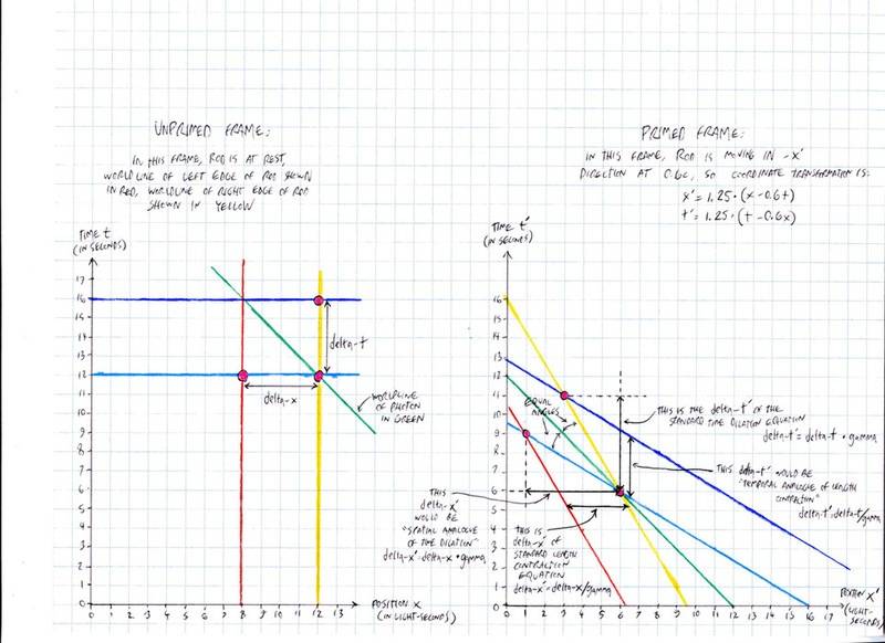

Here is another Lorentz transform image.
Notice that you can see time dilation for both observers here. Specifically, if you start at the origin and you go along the x'=0 line you see that it crosses the t=2 line before it crosses the t'=2 line (moving clocks go slow in the unprimed frame). Similarly if you start at the origin and you go along the x=0 line you see that it crosses the t'=2 line before it crosses the t=2 line (moving clocks go slow in the primed frame).
I will leave it to you to see how length contraction works.

I suppose that "the contraction itself" means the spatial analogue of time dilation, which looking at your drawing looks more like an expansion.
Yeah, the spatial analogue of time dilation is where you pick two events that are simultaneous in one frame, then figure out the distance between the same two events in a different frame--the distance will be larger, not smaller as with length contraction.

ok thanks, i get the diagram, including the length contraction. is it significant that the areas of the black squares and the white "squares" are the same? if it is, what's the argument which says they have to be? (if they do that is)
I don't know about the areas, but the scale is fixed by the first postulate. Specifically:
Let A = the distance from the origin to the intersection of x=0 and t=2
Let A' = the distance from the origin to the intersection of x'=0 and t'=2
Let B = the distance from the origin to the intersection of x=0 and t'=2
Let B' = the distance from the origin to the intersection of x'=0 and t=2
Then by the first postulate of relativity A/B = A'/B'.

thanks, it seems silly i missed something so obvious.
and of course, as the speed of the prime frame varies, a fixed point in the prime frame traces the parabola (hyperbola) in the unprimed frame mentioned in the first few posts. and also explains the - sign in the spacetime interval.
