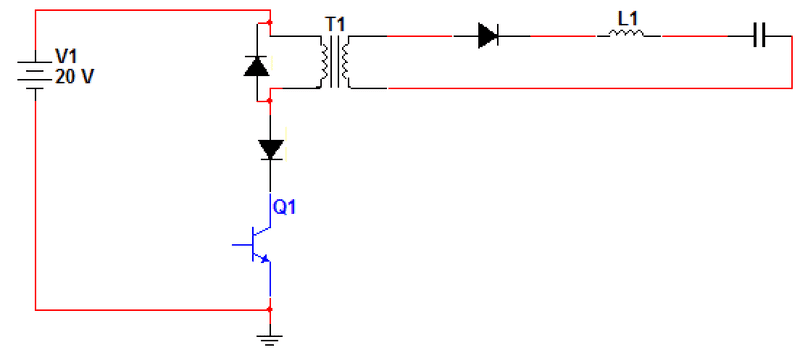

Circuit schematic of a transistor-switched transformer converter: 20 V source V1 feeds a center-tapped transformer T1 driven by transistor Q1, with diodes, and a rectifier diode feeding inductor L1 and capacitor.
Here's a diagram of what I have so far. The diode will prevent any AC from forming between L and C.
So far from the feedback I have received here (Thanks SunnyBoy) I need to:
-Calculate volt-seconds/Webers of primary coil during one cycle
-Select a core size and material
-Calculate Primary turns based on allowable core flux density
-Determine secondary turns and window area
-Ensure volt-second balance is maintained on all windings
I definitely have some studying and math to do, but it seems possible. I always like a new challenge to learn and build something!
I still would like to have more information on adding the current limiting inductor to the same core, but I have not found any instances where it's utilized.
Is there anything else I should consider in the design?
A couple of things to do in case you would like to proceed with a flyback converter:
* You can ditch the diode in series with the BJT.
* Replace the BJT with a MOSFET (100V / 10A should suffice)
* Output diode must be fast-recovery diode. SiC carbide diode should do wonders.
* The primary winding should not be shorted by the diode but have an RCD snubber instead. Place a resistor in parallel with a capacitor between the cathode of your diode and the upper winding node. R & C depend on leakage inductance and switching frequency.
* A flyback converter does not need an output inductor. Its output impedance is large enough not to cause excessive currents when in current-control mode.
* You can search for a flyback driver chip. Its datasheet should contain a detailed description on how to measure and limit the input current, which is a scaled version of output current.
With regards to the current limiting inductor: I suggest you take this learning experience one step at a time. Only once you have designed a functional prototype of a current-limited flyback converter, then you should proceed to a different kind of converter. Converters with inductors on the secondary (or primary) are called direct converters and are generally more complex than indirect converters such as flyback converter.
Btw. the flyback converter transformer is not really a transformer as much as a coupled inductor because the core stores converter energy. An air-gap will be needed.

I'd drop in a pre-made transformer, the VP5-0083-R from Digi-Key. I'd run two windings in series for the primary, three in series for the secondary, and leave one out.
For the control, I'd consider the LT3750 from Linear Tech. It's made for charging capacitors and will be better behaved than a regular flyback control.
This chip is easy on the output rectifier, so an MUR120 (or MURS120) from ON would be my first choice.
Linear Technology has a free spice package at their site and it's one of the easiest to use I've ever seen. It's got a nice graphical interface and will likely have the part and an example circuit for you to play with.
One bit of warning. In the LT datasheet, they didn't treat the issue of leakage inductance in the transformer. This will manifest itself as large voltage spikes on the Drain of the MOSFET at turn off. Generally, I use and RC snubber from the Drain to ground to deal with this. 330pF in series with 50 ohms is usually a good neighborhood to start with.
Best of Luck,
Mike :)
Ok,
First off, thanks everyone (espically sunnyboyNY) for your input. I have since designed a broadband transformer which has a clean output with little distortion and no backswing.
But I have more to learn...
The transformer has a 1:8.5 turns ratio. When I apply 7V pulses to the primary coil the load across the secondary (which should be about 60V) only shows about 19V. I know this is because I am overdriving the coil, but my question is; Where did I go wrong in my design that is preventing me from getting full voltage across the load?
I can increase the primary voltage and current, but it does no seem to change anything on the secondary side.
I am thinking it has something to do with the primary or secondary inductance, but if I knew for sure I would not be here.
Any help or suggestions would be greatly appreciated?
