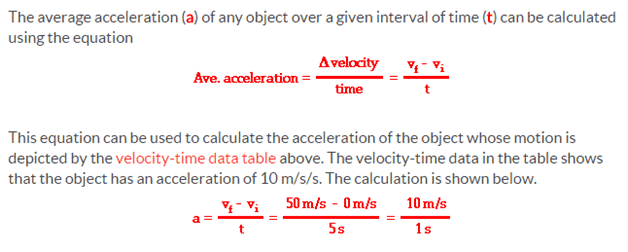

In regards to calculating acceleration, I have used the same formulas as above, but replaced displacement with velocity (the rate of change of velocity)

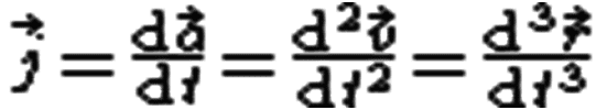

However, in regards to jerk (the rate of change of acceleration), I am trying to make sure I am calculating this correctly. I keep finding different formulas, but I am not certain all of them apply to 2D kinematics. If jerk is the rate of change of acceleration, am I wrong in thinking it can be calculated by acceleration divided by the time between each xy coordinate pairs?

The only difference between 2D and "1D" Kinematics is you have x and y components. So anything that applies to 1 dimension should easily apply to 2 with the help of a little trig and geometry. What different formulas are your getting?
Hi,
Thank you for the reply! I am using the following formulas.
Here are the jerk formulas
I assume this is the same as above
Those are the formulas I have found. The rest of the confusion comes from journal articles talking about jerk of arm movements. I am not sure if that is applicable to my situation. Does it seem like my thinking about the variables is correct?
Thank you.

That all looks ok, though I advise caution when dealing with real data. Each step in the differentiation chain can turn small errors into larger ones. You could apply some smoothing, but if overdone that will understate the values. You need to be aware of the precision of the original data and what that says about the answers.
You mention conflicting information regarding jerk of arms, but don't indicate what the conflict is. Is it possible those are not using "jerk" in this formal sense?
