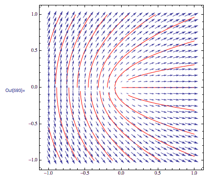

The reason is the following:
A differential equation has - depending on c - many solutions. Each solution corresponds to a flow through a vector field which is defined by the differential equation. The initial condition tells us where to start the flow, such that it will be the unique one that solves the equation plus its initial condition.
Plot of a two-dimensional vector field drawn as blue arrows on a grid over x from -1 to 1 and y from -1 to 1, with red curved flow lines following the arrows and converging toward the horizontal axis at the right.
ref.: https://mathematica.stackexchange.com/questions/22190/why-are-these-flow-lines-cut-short
