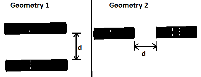

Ok I am concidering 3 different geometries, two are torroids, wound identically, from the top view and the third one is just bifilar coils, I suppose you could imagine a small magnetic core in the centre of the bifilar coils if you wanted:

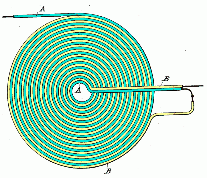

Say geometry 1 is on an angle of zero degrees and geometry 2 is offset by an angle of 180 degrees. I imagine that if they were 90 degrees offset there would be no mutual flux linkage as they would be perpendicular. I don't know how to calculate the coupling coefficients from the geometries but I imagine that geometry 1 would have more flux linkage than geometry 2 (as are functions of 'd') I woul guess it would be double the flux linkage of geometry 2.
As for geometry 3, from what I have read (but don't really fully understand) that if you just took L to be the inductance of winding A or B, equal to:
'N' (of A or B) squared / Reluctance
Then this series layout adds to yeild a total inductance of Ltotal = (LA + LB)*M = (L + L)*2 = 4*L, because the mutual coupling coefficient is 2 (how? I don't know), which kind of makes sense, I suppose there would be no stray inductance, but still sounds a bit high, too good to be true, unless the reluctance was something really small, not sure what, maybe the centre diameter of the wire length with a permittivity of air or if there was a core in there.

I assume your toroids have magnetic cores. The thing about a toroid is that the magnetic field is contained within the magnetic core. Geometry 1. If you stack two toroidal cores, each with it's own winding, then there will be very little coupling between the two windings. Geometry 2. The same containment applies, so there is little coupling.
http://en.wikipedia.org/wiki/Toroid...tal_B_field_confinement_by_toroidal_inductors
The third is a bifilar pancake coil. Because the windings are spread the coupling is not as good as you might expect. These can be complex to calculate, (see chapter 17 of Grover). There is also a correction needed because of the thickish insulation between the windings. When you connect the two filaments in series you simply double the number of turns which gives you four times the inductance of either filament by itself with the other open circuit.
http://en.wikipedia.org/wiki/Toroid...tal_B_field_confinement_by_toroidal_inductorsHmm, say that the toroids were more like an almost closed 'U' rather than a totally confined B-field, or a rectangle, there'd be more flux linkage then?
I haven't been able to get Grover yet, but I did find the attached .pdf of 'inductance calculation' exert from it (haven't had a good read yet even though its small).
Yes, that did cross my mind, that it is just like N = 2*Na = 2*Nb
so even if you connected the pancake like this:
The inductance would be the same? because the number of turns is the same? and its like [2^2 * N^2 ] / Reluctance
If so, what's the point of putting them in series rather than parallel?
Thanks
If two wires, joined at the ends, are wound together to form a spiral inductor, the inductance will be close to that of one wire only, while the resistance will be half of one wire only.
In parallel you are making Litzendraht wire. http://en.wikipedia.org/wiki/Litz_wire

As for were I got that picture, it was just from the wiki page (as you might have guessed, sorry, I remember your past advice) :
http://en.wikipedia.org/wiki/Bifilar_coil
It states "Some bifilars have adjacent coils in which the convolutions are arranged so that the potential difference is magnified (i.e., the current flows in same parallel direction). Others are wound so that the current flows in opposite directions. The magnetic field created by one winding is therefore equal and opposite to that created by the other, resulting in a net magnetic field of zero (i.e., neutralizing any negative effects in the coil). In electrical terms, this means that the self-inductance of the coil is zero." And I think the picture is from Tesla's patent.
Which to mean indicates the design is for more than just the convenience of centre-tapping.

Back in Tesla's day, low value resistors were wire-wound. That usually meant they were also inductive. Inductance was not a problem with DC circuits, but it was with AC. By connecting the two filaments in series so the current flowed in both directions, most of the inductance could be cancelled.
The pancake construction allows the W = I2R heat dissipated in the resistance to escape quickly.

When you said: "the bigger wire will have parallel current filaments that are further apart, so there is less "self coupling"."
What I want to clarify about that was 'so if you have two single strand conductors, the further appart they are (GMD) the less inductance they have because of the distance, I understand that. But say
you have conductor A, it has a self inductance, then you add another one, so conductors A and B are running parallel toughing each other, then they have a self and coupling inductance. Does this second sinario always lower the total inductance from just having conductor A on it's own? Or is it at a surtain GMD separation of the two that results in a lower self inductance in A and B rather than just having A?
If the parallel connected round wires carry half the current each then they have less inductance together than one round wire of the same diameter would have. If you increased the diameter of the one wire so it's GMD with itself was the same as the GMD of the two parallel wires, then the inductance would be the same. That is the elegance of GMD. The GMD applies both between the close turns of wire in an inductor and between the virtual filaments of current in a single conductor.
