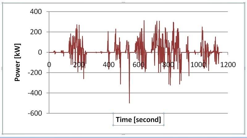

I will show you the power plot against time
As you can see the power curve does not have a pattern at all

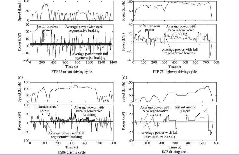

I have re-arranged my questions so that you guys can see more easily what actually I am trying to do;
Please see the attached picture;
These are 4 examples of 4 different drive cycles (vehicle speed VS time)
From that, using simple longitudinal linear dynamic equation, I then obtained a plot of tractive force against time. Finally, to convert force into power, simply multiply by a velocity.
Note that, only the data of velocity at each time interval is known (as a metrix)
However, I also need to know what the average power is, in order to properly size the engine/fuel cell, I have been given the above equation which involves integration.
My question is, how can I obtain the average power as shown in the picture?
Thank you very much again.

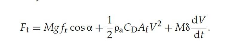

Well, the reason why the power is negative comes from the attached equation,
By knowing a specific driving cycle (velocity profile against time), in this case, I'm using a Bangkok drive cycle (Thailand), the remaining variables are already known, I could then work out the Tractive Force required at wheel in order for the vehicle to follow the drive pattern.
Where Ft = Tractive effort (N)
M = Bus mass (18000 kg)
g = gravitational accel. (9.81 m/s^2)
f r = rolling resistance coefficient (0.015)
[tex]\alpha[/tex] = road gradient (0 degree, flat road)
[tex]\rho[/tex]a = air density (1.146 kg/m^3 at 35 C in Bangkok)
CD = Drag coefficient (0.8)
Af = frontal area (7.8 m^2)
V = vehicle speed (m/s)
[tex]\delta[/tex] = mass factor due to rotating components, such as gears, wheels etc. (1.035)
t = time in seconds
The first term of the right hand side = tractive effort to overcome rolling resistance
The second term of the right hand side = tractive effort to overcome aerodynamic resistance
The third term of the right hand side = tractive effort to accelerate the vehicle mass
The spreedsheet is also attached to show the calculation together with the graphs, you can see that I did not include any Re-gen brake ability, but I believe the negative power is just a result from the negative values of the third term on the right hand side (effort to accelerate the mass), which is a result of negative dV/dt
I do not quite understand what this actually means by the NEGATIVE power in some parts of the plot. How can power be negative? Can anyone help? please.
Most important, how can I find the AVERAGE power from this? So that I could determine the appropriate size of engine/fuel cell. If this is to use the above integral equation, how can I do this?
