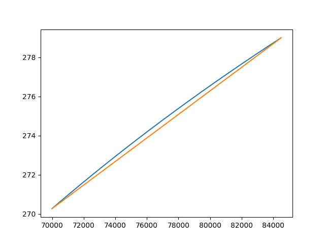

To get an even more accurate numerical solution to the differential equation, I'm thinking of integrating it numerically using a Forward Euler 1st order accurate finite difference integration scheme with 100 pressure steps of 0.145 bars each. I can do this on an Excel spreadsheet, but I have to decide whether this is really worth the effort (or whether we have already beat this one to death).
  • #40
I think I could do it in C++ or Python. Use the Clausius-Clapeyron equation for ps for each temperature?
  • #41
Of course.

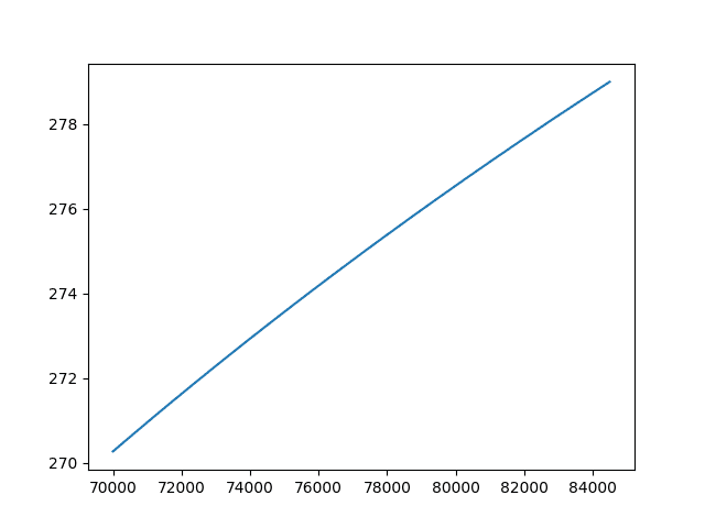

  • #42
So I get 270.27K as a final temperature. I have done calculations using dP step equal 0.01 Pa and I have verified it by comparing result to 0.001Pa step. Suprisingly I get relation very close to linear function:

It took me 15 min to implement the integration with Excel that I indicated in post #39. For the temperature at M2, I got 270.3 K, compared to the value 270.5 K that we got with the simpler method. The predicted amount of water condensing was 2.42 g/kg vs the 2.45 g/kg in the problem statement. Not bad!
  • #44
I just noticed that we both got the same result for the final temperature (and, thus, for the rainout). Very satisfying. (Actually, for an additional significant figure, I also got 270.27 K)
