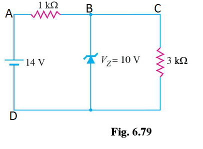

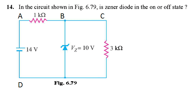

I assume that the zener diode is on.
For this the current flowing through 1k##\Omega ~~i.e. ~~I_1## should be grater than the 3k##\Omega## i.e.##I_3##.
##I_3= 10/3~ mA
\\I_1 = 4 ~mA##
Clearly,##I_1 > I_3##. So, there is some current going through the zener diode. Hence, the zener diode is on.
Is this correct?

Your analysis is correct.
Thank you.
You could also see that without the zener the voltage would be 14/(3/4) = 10.5V which is > 10V.
Likes Pushoam
