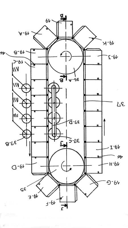

figure out the total energy that a system of buckets, suspended on a chain system around pulleys, assuming the pulleys are 10 meters in radius, and that each bucket is 1000 cubic meters, falling for 30 meters. I used the simple mgh formula, but not sure how to factor in the radius. Also, how fast does the system have to run to produce maximum power and whether a gearbox might be used to take off power at slower revolutions
I am trying to figure out the total energy a system of falling buckets can produce, and whether it would be a system that can replace or enhance a system of turbines in a hydroelectric dam situation. I need to figure out the total energy that a system of buckets, suspended on a chain system around pulleys, assuming the pulleys are 10 meters in radius, and that each bucket is 1000 cubic meters, falling for 30 meters. I used the simple mgh formula, but not sure how to factor in the radius. Also, how fast does the system have to run to produce maximum power and whether a gearbox might be used to take off power at slower revolutions. Thanks
The simplistic energy calculation is easy. The difficulty in this is calculating the efficiency. The water is falling at a certain velocity when moving with the bucket, and that energy is lost when it empties at the bottom (in addition to any height it falls). That's a source of inefficiency and is hard to calculate.
My understanding is modern turbines can be something like 90% efficient and that is going to be tough to beat.

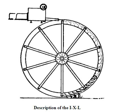

Interesting. I did some searching and didn't find any images of the "Modern Fitz I-X-L steel overshoot water wheel". Does anybody know what it looks like, and why its efficiency is so high?
As I see, due the nature of that 'Angelfire' page (collection of old resources) actually that table about the efficiency might be even a century old: you should adjust the 'modern' part accordingly... :woot:
As far as I can tell, the theoretical limit for a water turbine should be 100%, so it doesn't surprise me they can achieve above 90%. This is unlike a wind turbine where the limit is 59% or 61% depending on the theory applied.
It's possible that web page was written by Fitz I-X-L :rolleyes:

My google gets plenty of image hits for "I-X-L steel overshot water wheel":

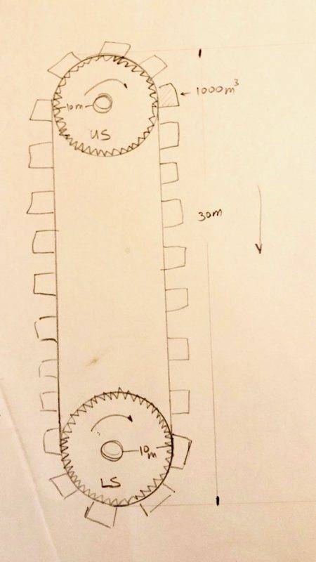

Ok, so here's what I got so far. The one water filled bucket, falling from the top of the upper Sprocket, "uS," will exert a certain maximum downward force upon the chain it is attached to, which will pull on the uS, and force it to follow the chain that is being acted upon. The inner shaft of the uS, which is connected to a generator, will spin the shaft of that generator, and electrical current will be produced, which can then be used.
The bucket on the right side of uS, and is at 30m, and falling at a constant speed (determined by the braking power of the generator - similar to the braking power of a regen system in electric vehicles). It is 1000 cubic meters in volume, which translates to 1,000,000 liters, or 1 million kg, has a maximal potential of (1,000,000kg x 9.81m/s^2 x 30m), or 294,300,000, or 294.3 megawatts.
That figure of 294.3MW is the maximum power that could be generated by this system.
Is that correct?
Would the speed of the bucket be a factor?
Would the distance of the bucket from the shaft be a factor?
Is that correct?
Yes, that math skips a step to get to megawatts: diving energy by time. The number without units isn't megawatts, it is joules. Megawatts is joules per second, so the number in megawatts is the power if the bucket travels down the 30m in one second.
No.

Ah. So there’s the tie-in to momentum. So if it traveled the 30m in 1 minute then it would be 294.3 mw divided by 60?
