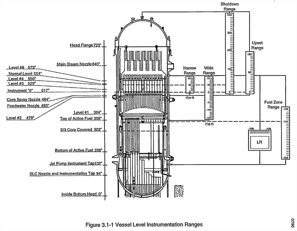

  • #7,843
NUCENG said:
Very important: If level 0-reference is Top of Active Fuel Unit 3 core uncovery began at about 1600 on 3/11. Because multiple SRVs were cycling and HPCI apparently did not start, the coolant discharged through SRVs was more than RCIC could make up so level continued to drop after RCIC started. It would be assumed they were able to recover level after the time of these graphs or it would have been unit 3 needing to be vented first.
I think you are referring to page 1 of this:
https://www.physicsforums.com/newreply.php?do=newreply&p=3310549
That caught my eye at first too, but then I looked at the following:
http://www.tepco.co.jp/nu/fukushima-np/plant-data/f1_2_Chart3.pdf
If you look at pages 3 and 4, you can see what looks like the same
behavior being recorded by a different sensor (?) on a paper strip
chart that has been scanned in. There are two scales at the bottom,
which differ in both offset and scale factor:
原子炉水位 (広帯域) [mm] = Reactor water level (wideband) [mm]
and
原子炉水位 (燃料域) [mm] = Reactor water level (fuel region) [mm]
The zero offsets are different, and I am guessing that the second one
is the one with zero referenced to the tops of the fuel rods. (That
would match TEPCO's labels elsewhere where they report that.)
I think what was shown in the first link above is the "wideband"
(wide area?) scale, whatever that is.
If this is correct, then the Unit 3 fuel rods did not get exposed
on the 11th, at least as far as these charts show.
What do you think?

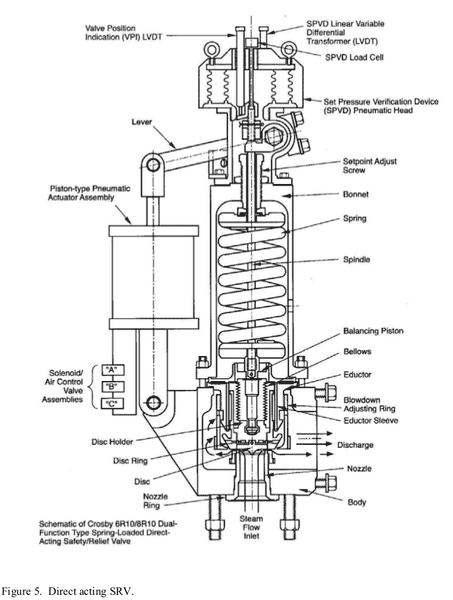

  • #7,844
rowmag said:
The zero offsets are different, and I am guessing that the second one is the one with zero referenced to the tops of the fuel rods. (That would match TEPCO's labels elsewhere where they report that.) I think what was shown in the first link above is the "wideband" (wide area?) scale, whatever that is.
If this is correct, then the Unit 3 fuel rods did not get exposed on the 11th, at least as far as these charts show.
What do you think?
This may or may not be relevant, but the attached diagram shows typical GE BWR instrumentation levels. Notice there is a level called "Instrument 0" and all other measurements are relative to that reference level. In this particular diagram "Instrument 0" is not the same as the top-of-fuel level.
The full-size diagram is found on page 117 of this GE BWR Tech Manual:
http://atominfo.ru/files/fukus/023020088.pdf
The right side shows a "narrow range" gauge and a "wide range" gauge. Maybe a similar measurement arrangement is used by TEPCO.

  • #7,847
and
What do you think?
My comment was based on the first page of:
http://www.tepco.co.jp/nu/fukushima-np/plant-data/f1_6_Katogensho3.pdf
On that chart there is no mistaking the scale.
In plants I have worked at there may be as many as four different zero references.
The first is the elevation (above sea level).
The second is AVZ (Above vessel zero) which measures from the bottom inside of the RPV
The third is TAF which sets 0 at the Top of Actve Fuel.
The fourth is AIZ (Abave Instrumrnt Zero) which basically references level (positive and negative) from the midpoint between the top 2 instrument taps.
The human factors lessoned learned after TMI2i ncluded control room modifications to use one reference. However some plants picked a different one.
So I looked for clues for which one this is. In a typical US plant the top two instrumment taps are around 10 feet apart or about 3000 mm. , that would measure levels between +1500 mm and -1500 mm. F1-3 is slightly bigger so +1800 mm to -1800 mm makes sense. Narrow Range in the graphs then is being based on only the positive half above instrument zero. and they weren't close to core uncovery.
Physically, TAF would typically be around 10 feet or more below this instrument zero reference. Again, -4000 mm on the Wide Range Instrument makes sense for a bigger plant.
I think you are right that they weren't close to TAF yet.
I am still stuck with why F1-3 had so much SRV activity compared to F1-2. It has to be the delay in getting RCIC started. I need to go back and read some of the early press releases. I now remember reading that F1-3 had HPCI running and later tried to switch to RCIC but were unsuccessful.
That too makes more sense now. SRVs were taking more coolant out than RCIC could make up, so they would have switched to the bigger HPCI pump to recover level. HPCI is usually 4-5 times higher capacity. But HPCI uses more steam. As pressure dropped they would want to use the smaller pump to prolong makeup flow.
Anyway, thanks for the catch.
WATER LEVELS:
Something is unclear (at least comparing it to data from Daichi) in this manual for reactor water levels I think as they say that for reactors other than BWR/4 model, the "fuel zone range" for reactor water level uses Top OF Fuel (TAF) point as instrument zero (which is what we see in the measurements: 0 is TAF and - is below top of fuel), instead of the "instrument 0" that your refer. This is explained page 112 of the above manual.
In other words:
for BWR/4 ->> Instrument 0 is defined as 516 3/4 inches (13,12m) "above vessel zero" (AVZ) which measures from the bottom inside of the RPV. This "Intrument 0" is then located in an area close to steam dryer at the very top of the vessel (see page 107)
for other models: -->> instrument 0 = Top of Fuel (TAF) FOR READINGS IN THE "FUEL RANGE" (only)
Unit 1 is BWR/3 , Units 2,3,4,5 are BWR/4 and Unit 6 is BWR/5 (with Mark II containment).
But it seems that all the readings we have for all reactors (including BWR/4) use TAF as zero? Which is not consistent with the manual you listed i think?
But maybe they just changed this since the manual was written to have some uniformity between the reactors (that would be a good idea for the operators!).
So be careful, there are maybe other differences between the manual and what is implemented at Daichi?
DETECTION OF HEAD FLANGE LEAK: It seems there is a system to detect the presence of water i between the two O'rings that seals the flange (RPV head/ RPV). There should be an alarm when detected or even a measurement of the leakage (which is collected to a drain). See page 122 of the pdf. But it is indicated page 106 that using this procedure to read the leak rate steam cuts further the inner seal making the leak even worse! Great system...
I don't know but maybe you will see some parameter somewhere in the buch of data showing this information, indicating some possible leakage at the flange...
Do you think there could be a "kind of similar" detection of leakage of steam+H2 from the top cover of the containment vessel?
Forgive me if this is nonsense, but NISA has always reported water levels from TAF (starting March 14). Would that be an indication that TAF is the zero point?
http://www.nisa.meti.go.jp/english/files/en20110315-1.pdf
