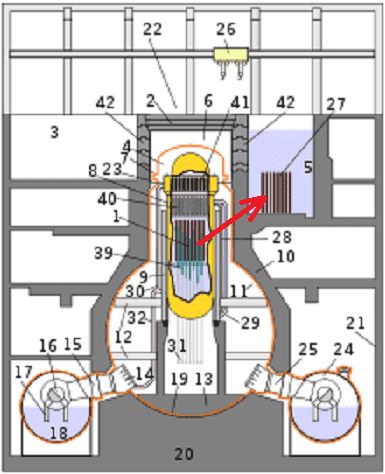

In my opinion the explosion of #3 from the spent fuel pool is much worse for Japan and the rest of the world than if the explosion occurred in the reactor itself.
So, many here have jumped on me about my theory that the explosion of #3 came from the reactor containment. Some argued that is not possible, and that it must have come from the spent fuel pool of #3. Arnie Gunderson thinks the explosion is from the spent fuel pool of #3.
I believe if the explosion came from the spent fuel pool of particularly #3 , but possibly others, it's way worse, and I hope that is not the case.
First, we acknowledge that in both the reactor and the spent fuel has plutonium in it. The plutonium comes from two sources: First it comes as a by product of the fission reaction in the reactor. I don't think that plutonium is a great risk, because the molecules are interspersed in the rod fuel. In a complete catastrophic explosion, it would not travel far from the reactor.
The second source of plutonium is the mixing of finely ground (nanometer) plutonium powder with the uranium in the new fuel rods that were placed into the #3 reactor in August. Alternatively known as MOX fuel, they mix between 6% and 15% plutonium powder in. I believe the Fukushima rods were somewhere in the lower half of this range.
During manufacture, the powder is "sintered" into pellets. What is unclear in everything I have read is whether the sintering melts the powder into solid metal pellets, or whether it simply binds the material into a pellet, but the powder still remains on the inside. Given my knowledge of powder metallurgy it takes a lot of heat and pressure to render powder into solid metal, and I suspect they would not subject the plutonium to enough to completely bind it, for fear of a reaction during manufacturing.
Once the rods are brought to operating temperature in the reactor core, my guess is they reach a high enough temperature to bind the powder completely. I haven't found anything specific on this topic, so if it's been discussed here, or someone can point me to it, then I apologize in advance. If my guess is correct, then even if the reactor core exploded, it would not pose a very widespread damage to the environment - from plutonium at least - because the bound plutonium would be released in relatively large chunks.
However there exists the possibility that new plutonium enriched rods were waiting in the spent fuel pools to be loaded. If my analysis above is correct, these rods would not have their plutonium bound yet, and in the case of an explosion, the nanometer powder could be released.
I guess this is more of a set of questions for discussion rather than a statement. My question would be this: 1. Does anyone know if the plutonium powder is bound into solid metal during the sintering process? 2. Did any of the spent fuel pool contain plutonium enriched rods ready to be loaded? and 3. If so, is this a danger if the #3 spent fuel blew up rather than the reactor?
Again, pardon my ignorance if this has already been discussed thoroughly.
