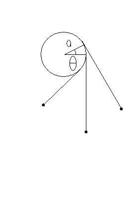

Find the Lagrangian and the Lagrangian equations for this pendulum (see the picture). Radius of circle is a, mass of the bob is m and l is the length of the pendulum when it hangs straight down.
I obtain:
[tex]L=\frac{1}{2}m(a^2\dot{\theta}^2+(l+a\theta)^2\dot{\theta}^2)-mg(a\sin\theta-(l+a\theta)\cos\theta)[/tex]
while the answer in the book misses the term [tex]a^2\dot{\theta}^2[/tex] - where have I gone wrong?
Thank you in advance.
  • Diagram of a pendulum wrapped around a circle of radius a, with angle theta marked at the centre, a straight segment of length l hanging vertically down to a bob, and a second segment leaving at an angle to a bob on the left.
How did you get that extra term? The x,y coordinates of the bob with respect to the centre of the circle are x=a cos(θ)+(l+a)sin(θ), y=sin(θ)-(l+a)cos(θ). Take the time derivatives to get the x, y components of velocity.
