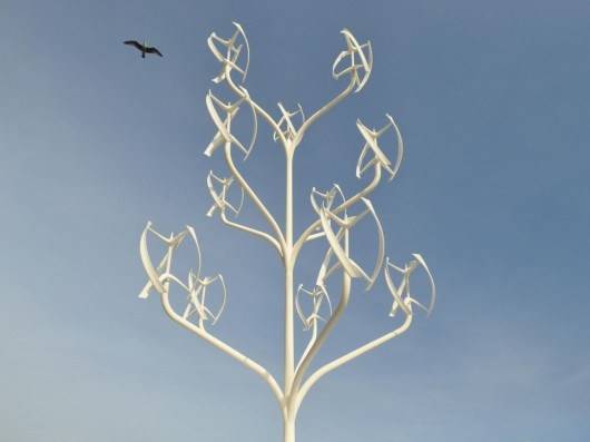

I recall reading an article some years ago about a plan to fix electricity "generators" to trees. The idea being to generate electricity as the tree bends and flexes. I forget the details.
I'm always suspicious when architects and artists get involved in engineering problems:
Click on the image for the article at gizmag​
Very pretty, but probably very spendy for their output. But then again, until "those people" get over how "ugly" conventional wind turbines are, it might be a good idea.
Likes russ_watters

Yeah those artistic wind machines are usually very inefficient in terms of energy extracted per unit area and cost, compared to a "normal" wind turbine.
