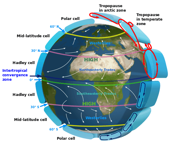

One other thing to think about is that all the winds on Earth are due to rotating flows. Whenever the wind blows one way somewhere on earth, it is blowing the other way somewhere else. (Else the wind would pile up on one end.:smile:) The rotational flows are caused by the sun and related to Earth's natural rotation. The sun heats water and air which rises in pockets of both narrow and broad columns. When the air rises (warm air and vapor rise), other air must rush into fill the pressure void. This wind is also encouraged to rotate just as does a bathtub drain. We may say all atmospheric air movement is of this nature.
Which brings us to the reason windpower is desireable. A bit ago I said that not just air, but also water rises. Very few people realize that water is lighter than air (as vapor). So extra newly heated rising water is largely responsible for our current, more aggressive weather changes. The ocean water is being heated to an extra degree (literally) by extra greenhouse gases trapping heat near the ground. The warmer water therefore evaporates easier and rises more quickly, dragging more atmospheric air with it. Caught in the throes of global warming, we now have more overall earthern wind than we had before. The solar power delivered to Earth is pretty much the same to be sure. But less re-radiation of entrophical heat is escaping to outer space. Unfortunately the usual escape route is slightly more blocked mostly by the "thicker" blanket of greenhouse gases formed by fossil-fuel carbon dioxide and the boot-strap effect of more water vapor at any given time. We need windpower to off-set this.

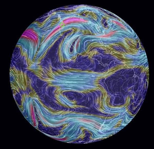

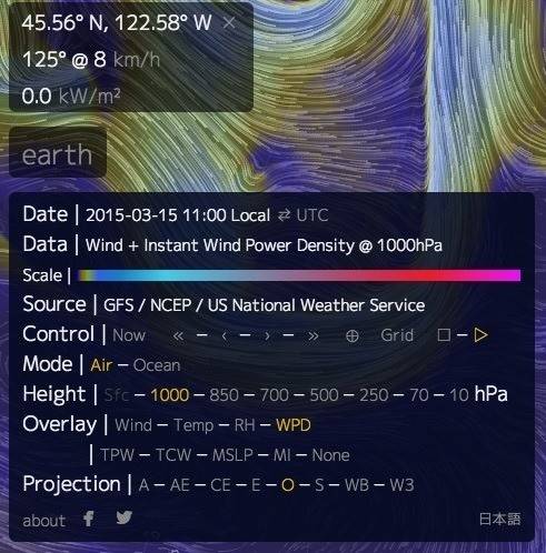

And, I don't mean to catch anyone off guard. I just find some questions very interesting, and don't really have an answer, so I design over-simplified models in my head.
One thing I forgot,
OmCheeto said:
Heat and torque.
was acoustic energy. Trees are very noisy when the wind blows. But, as you said; "Entropy". :smile:
But these hypothetical questions are very difficult to model. You have to start out with ideal "text book" initial conditions, and then start adding in your pieces of duct tape and fans.
I've been thinking about my "torque" comment the other day, and decided it might need more research. I may be completely wrong about it.
If the Earth were a solid perfect sphere, with no features, no moon, and no skin effect drag on the atmosphere, then the atmosphere would probably get tidally locked to the sun. If you added a single tree, at the equator, would not some of the energy of the atmosphere get transferred to the Earth, via the non-perfect tree?
If the Earth were a solid perfect sphere, with no features, no moon, and no skin effect drag on the atmosphere, then the atmosphere would probably get tidally locked to the sun. If you added a single tree, at the equator, would not some of the energy of the atmosphere get transferred to the Earth, via the non-perfect tree?​

If the Earth were a solid perfect sphere, with no features, no moon, and no skin effect drag on the atmosphere, then the atmosphere would probably get tidally locked to the sun. If you added a single tree, at the equator, would not some of the energy of the atmosphere get transferred to the Earth, via the non-perfect tree?"
You may not be completely wrong about such a torque. According to meteorology, the Coriolis effects, (http://en.wikipedia.org/wiki/Coriolis_effect#Meteorology) that are part of the surface wind equations, cause trade winds (http://en.wikipedia.org/wiki/Trade_wind) that are distributed in a seemingly detrimental direction against Earth's rotation. Whereas the continuous replacement air to feed such a movement may come from more polar regions which are close to the slower moving upper latitude surfaces, the easterly trade winds blow counter to day-night rotation very near the equator, giving them apparent lateral leverage advantage to retard Earth's rotation via friction. In other words, this process may be counter-pressurized in areas close to Earth's axis, and then possibly more in sun-driven polar vertical loadings, leading to unbalanced equatorial surface drag.:nb)
Then on the other hand, with mixed wind directions, it also depends on how hard the wind is blowing across any given surface and how many windmills, trees or tabs of tape there are in it's path. You are quite correct, the process is very complicated, but it does appear from this knee-jerk vantage that sun power, besides that of gravitational tidal forces on water and soil, is applied to gradually slow the rotation of earth. Coriolis wind energy must come from somewhere, and I still believe it is as I said earlier, primarily the sun. But putting my earlier statement about sun energy only, in question, the wind may also be deriving energy from, and somehow robbing Earth of it's rotation... depending. Maybe we need to tap into the jet streams with Earth anchored kite generators since they are going in the right direction to keep us spinning, probably a good thing. :wink:
OmCheeto, is some of this along the lines of what you are thinking?
A tidally locked gaseous body is an interesting concept and worthy of it's own thread. I say this because basically, if there were no skin drag effect from solids, it seems our atmosphere "shell" would act unaffected by the liquids and solids beneath it, just as though it were a thoroughly gaseous heavenly body, and therefore it should logically tidal-lock either way. The tidal "periodical stretch" slowing of a rotating gaseous body might ostensibly be most minimumly caused by the "slipperier" friction of it's fluid gaseous molecules, just as tidal-lock rotational slowing gradually occurs by the supposed greater tidal friction of liquid (and greater yet, semi-solid particles). So the gas friction would seem to be lesser, but so would the rotational angular momentum of a low body mass of gas be less also. This might even be a wash as to whether an atmosphere immune to solid core friction would tidal-lock first before the core.
