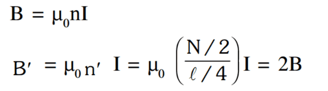

I am having trouble interpreting the language of the problem statement . What does it mean that "half number of turns are wound " ?
When the solenoid is cut , the length becomes 1/4th of the original and number of turns also become 1/4th of the original .
I think the problem is not difficult if only I could understand the question .
Thanks .

That is a strange question. Are the four equal parts picked up again later?
If not, I don't understand that part. I would assume the density of the windings (windings per length) is halved.

What does it mean "half number of turns wound on anyone piece " ?
Well, the sentence does not use correct English grammar, so it is a bit speculation, but I interpreted it as "For each quarter, we halve the winding density". For the following question this means the quarters don't matter.
This interpretation gives option 4) . Right ?

You didn't use the part about quarters to arrive at the answer of B/2, right?
Option 2) is the answer given .Please see the solution .
I think what they ( paper setters ) are trying to do is halving the total number of turns (before the solenoid is cut ) and then fitting those N/2 turns in the length L/4 ( after the solenoid is cut in four ) . Strange interpretation :wideeyed: .
Please let me know if the official solution makes sense to you .
I can see how you could interpret the problem that way, but the phrasing is unnecessarily complicated and ambiguous.
