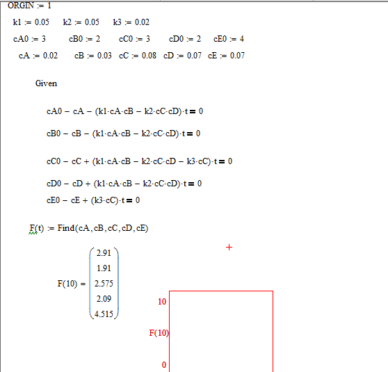

My mathcad all the time show THIS VOLUE MUST BE REAL. This is my equation:
https://www.physicsforums.com/attachment.php?attachmentid=52208&stc=1&d=1350934907
THX for help

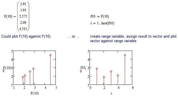

I can't see the entire plot to try and work out what you've done ... posting a worksheet as well as an image is generally helpful as several problems are not obvious from just a screenshot (also saves respondents typing things in). Try plotting F(10) against F(10), or assiging F(10) to a variable and plotting that using a standard range variable technique.
See attached Mathcad 11 format file.
