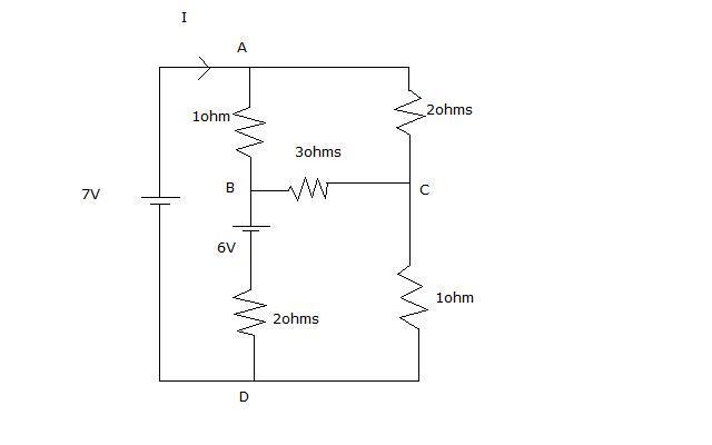

For the following circuit determine:
I, Vab, Vac, Vbd, Vcd
See attachment for circuit diagram.
Mesh Analysis method
Using mesh analysis:
-7V + I1 - I2 + 6V + 2I1 -2I3
= 3I1 - I2 -2I3 ------------------mesh 1
2I2 + 3I2 -3I3 + I2 - I1
= -I1 + 6I2 -3I3 -----------------mesh2
I3 + 2I3 -2I1 -6 + 3I3 - 3I2
= -2I1 - 3I2 + 6I3 -6 -------------mesh 3
Have I done this correctly? How do you get I from this and the voltages?
Thanks.
The right hand side is missing the voltage. The sum of the voltages around each loop = 0.
The polarity convention is reversed. I would have done it:
7V - I1 + I2 - 6V - 2I1 + 2I3 = 0, for mesh 1.
So, 7V - 3I1 + I2 + 2I3 = 0, and likewise with the others. One then has 3 equations and 3 unkowns (I1, I2, I3), for which one can solve. Simply add the equations together and eliminate all but one current so that currents are found in terms of voltage and resistance.
Then Vab is just the voltage drop across the resistor (1 ohm) or Va - (I1-I2) 1 ohm = Vb or Va - Vb = (I1 - I2) * 1 ohm.
