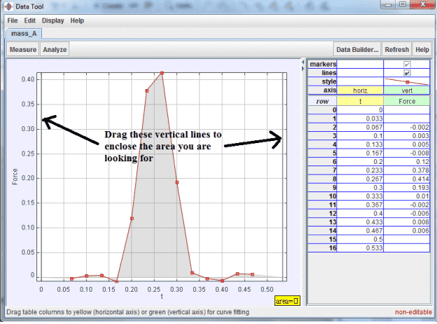

It was a really crappy one second video of a puck bouncing off a fence.
Yes it was a force vs time graph. Right when the puck bounces off the fence, the force exerted on the puck (according to the graph) was 0.37N of force.
Here is an image of the graph. I am still confused about why my force in my calculation is off...
Please note at the top of the graph (around 0.25s) that's when the puck is bouncing off the fence. Also on my graph I used 0.37N because that was what I had, this is the demo graph from my class which used 0.42N at 0.25s.
I'm as confused as ever.
Are there two graphs of force against time, one that goes with the video and one from your own data? If so, please post both.
What makes you think the video experiment should involve the same forces that arose in your experiment?
What do you mean by "I used 0.37N because that was what I had". Where did you get 0.37N from in connection with your experiment?

It was from the graph I made given the same information as how the demo graph was made. I followed some instructions. I did it again and thankfully this time I had 0.42N as my max force when the puck bounced off the fence. The puck video was used to make the demo graph and my graph that I am making myself.
So both graphs were created from the video?
Are you trying to simulate the video?
I note that in the graph the contact time was about 0.15s, three times as long as you used in your calculation. Or are the units in the graph not seconds?
Yes both from the same video.
Yes, I had to use a program that tracks the movement of the puck and gives a graph of the movement. Interesting.. I did pick a long time, thanks for the note! they are used in seconds yes. Thanks! I really do make dumb mistakes a lot lol.

After looking at it again I thought it was about 0.08 seconds of contact. 0.15 would make more sense for my average force though. The average force should be around the middle right?
I read it as lasting from 0.17s to 0.33s, a duration of 0.16s.
Thanks for your help. My question all makes sense now, I am just a buffoon!
Yes, now you have the time right, it all works out ok.
Just as an aside, I notice the force time graph is approximately triangular. So whatever the time was, even if there had been no markings on the time axis, the average force is about half the peak force.
(Average height = area / base = 0.5 x base x peak height / base = 0.5 peak height)
And since I wan't sure how the graph peaked between the 0.378N and the 0.414N points - ie whether it rounded off nicely just about there (which is how it appears in the video), or had shot up to a high peak between the two sample points (as if perhaps it had hit a solid backstop) - the result of your calculation, which now gives mean force 0.22N, suggests the peak is indeed about 0.44N,
