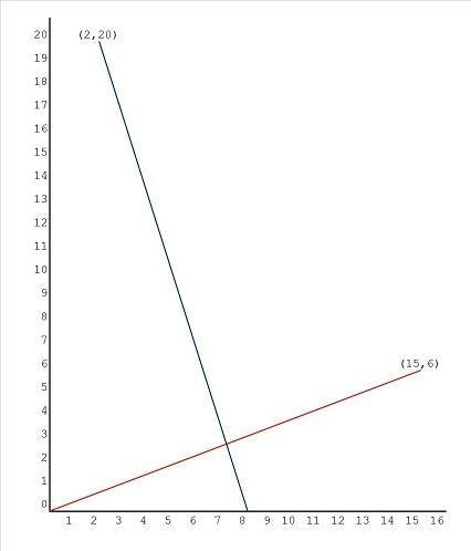

I don't know. I can't follow what you've written and I'm not going to finish your calculations.
The answers are
red worldline ##\tau = \sqrt{(14.54)^2 - (3.64)^2} = 14.08 ##
other worldline ##\tau = \sqrt{(14.54)^2 - (8-3.64)^2} = 13.87##
stationary worldline ##\tau = 14.54##
I'm hoping you might grasp some of the princples of relativity from this exercise.
You have made spacetime diagram, and calculated some proper times, so it could be progress.
Can you work out the time on the blue worldline when a light beam from the origin hits it ?
The answers are
Hits it.
Hits who? Blue worldline?
##\sqrt{14.54^{2} - (8-3.64)^2}##?
13.87 you mean?
The lights hits Blue when his clocks is 13.87?

Stephanus said:
No, not perpendicular. But 450 from vertical lines. That's how x = t
Tell me. Which one?
This one. The WL of the light is as you say ##x=t## and the thing is on ##x=8-vt## so you can get the intersection on the appraoching WL.
Then make a triangle and work out a ##t^2-x^2## and you got it.

I think the latter, let me calculate.
for x = t from the origin, so...
##t = x - \frac{2}{0.55}## this is 450 from origin
##0.3t = 8-x## this is b velocity
They will meet at...
##1.3x - \frac{0.6}{0.55} - 8 = 0##
##x ≈ 7##
##t = \frac{1.85}{0.55} = 3.36##
The signal from the origin hits B at (7,3.36)

Solving ##x=t## with ##x=8-vt## gets ##t=8-vt## so ##t=8/(1+v)=6.15##
and ##x=6.15##.

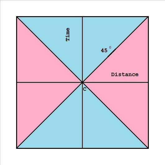

The light that comes from the origin.
If this is a Spacetime diagram. And C is the centre.
Is it true, that C were/will never be in magenta area? Not even in 450 lines?
Is it true, that C could be in the cyan area below?

  • #64
Events can exist at every point on the diagram. An event is a pair of numbers (t,x).
  • #65
But, for events to happen at the magenta region, that events should travel x>t?
I mean travel faster than light from c point of view?

  • #66
Events can exist anywhere, and they don't "travel". Things that are traveling appear as sloped lines in your graph. Events are points on your graph. More physically an event is something like turning on your rockets. That happens at a point in space at an instant in time, which can't be said to be moving.
That said, you are correct that events in the magenta region cannot be reached from the origin without exceeding the speed of light. An example would be a car crash in London and a simultaneous (in some frame) car crash in New York. If one was at the origin the other was in the magenta region.

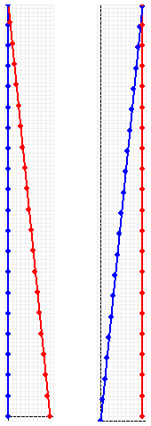

In the left-hand diagram, the supernova is in motion and we are at rest. Note that the red dots are slightly wider spaced than the blue ones because of time dilation - there are 20 red dots and 21 blue dots. In the right-hand diagram, we are in motion and the supernova is at rest. In this frame our clocks are time-dilated, but we started them early - so there are still 20 red dots and 21 blue dots.
I haven't drawn on any light pulses because they aren't necessary to understand what's going on with the clocks. I repeat that I would advise not worrying about them - I think you are confusing yourself by trying to sort out the details of what we would see without having a grasp of the big picture.

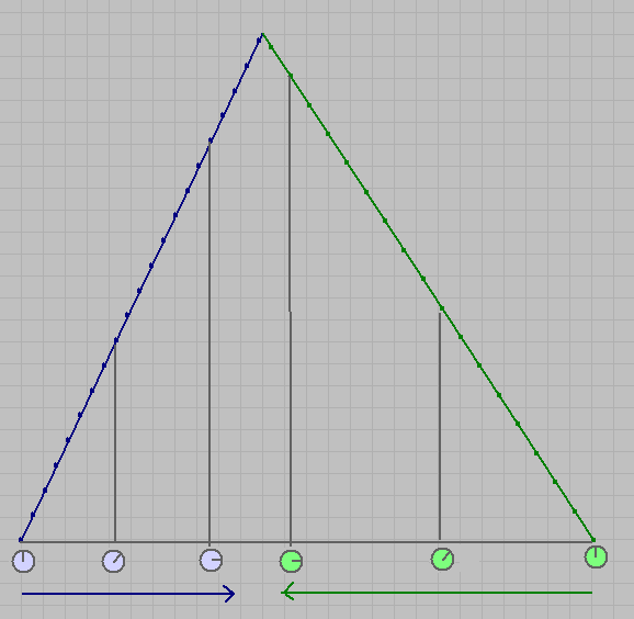

I made graph of the two objects approaching each other on the x-axis with images of their clocks as they progress. The dots on the worldlines are clock ticks.
1. Note that all the spatial movement is in the x-direction ( or -x direction )
2. The worldlines show the progress through spacetime.
3. The time and place ( t,x) where they meet is an example of an event.

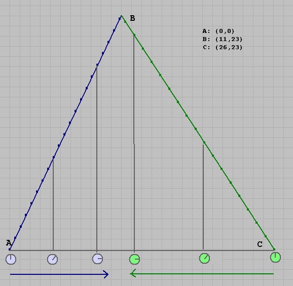

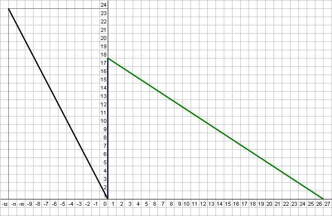

Let me try to solve the problem.
At rest frame:
A speed is 11/23
C speed is 15/23
A meet C at time 23
Is this the space time diagram if Blue/A is rest? The Black line is the moving rest line in previous graph.
Green is green line from previous graph.
Blue is at (0,17) because ##\sqrt{23^2 - 11^2} = \sqrt{408} = 16.94##
  • #76
At rest frame:
A speed is 11/23
C speed is 15/23
A meet C at time 23
The 'shape' is right. Blue stays at x=0, green approaches and the line that was at 0,0 moves to the right.
The proper time on Blues clock is about 20.2 (counting the dots) but on your diagram the time on Blues clock is about 17. That is not right. They should be the same.
If you want to transform the diagram to Blues rest frame, you should transform the points A,B,C with a Lorentz transformation with velocity -v where v is Blues velocity.
I transformed B ( t=23, x=11) with ##\beta=-0.478, \gamma=1.138##
##x'=(11)*1.138-(0.478)*(1.138)*23=0.005##
##t'=(23)*1.138-(0.478)*(1.138)*11=20.2##
There are rounding errors but you can see that ##x'## goes to zero.

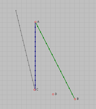

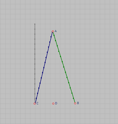

These diagrams are fairly accurate but not the same numbers. I won't be available for a while now.
