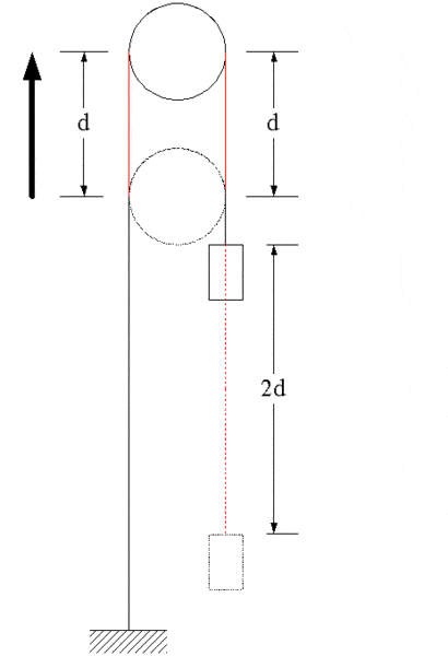

Find acceleration of block 1, knowing that the mass of block 1 is 2kg and of block 2 is 4kg. You may ignore friction and pulley mass.
Fr = ma
I Drew free body diagrams to block 1, 2 and the pulley, then made the equations:
<br /> \\<br /> \sum F_{r2} = m_2a_2\\<br /> P_2 - T_2 = m_2a_2\\<br /> \\<br /> \sum F_{rpulley} = m_{pulley}*a\\<br /> 2T_2 = T_1\\<br /> \\<br /> \sum F_{1}=m_1a_1\\<br /> T_1=m_1a_1\rightarrow T_2 = \frac{m_1a_1}{2}<br /> <br /> \\\\a_1=2a_2 \rightarrow T_2=\frac{m_1(2a_2)}{2} = m_1a_2<br /> <br /> \\(Substituting\ in \ first\ equation)\\<br /> P_2-(m_1a_2)= m_2a_2\\<br /> a_2(m_2+m_1) = m_2*g\\\\<br /> a_2=\frac{m_2g}{m_2+m_1} = 6.53\frac{m}{s^2}\rightarrow a_1 = 13.06\frac{m}{s^2}<br />
The answer, however, is supposed to be 4.4 m/s²
Thanks in advance!
Is ##a_1 = 2 a_2## true?
Well, I think it is, isn't it?
If 1 moves a distance "d", 2 will move only d/2 because the rope has to run on both sides of the pulley.

On the other hand, if 1 moves a distance "d", the pulley "takes" a length "d" of rope from both sides of the pulley. This rope can only come from the free end holding m2.
Wow, that... that makes a lot of sense, so in fact a1 = 2a2
Thanks a lot, gneill!
