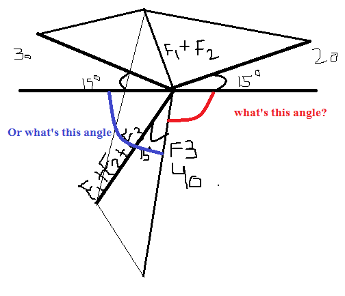

I guess you know how to do this ? Or not yet?
Actually no...
Okey, you are given three forces and their directions (by angles) right?
Now look at the way I tried to draw your problem in a diagram. Are my angles correct?
For F1 and F2 it seems that your diagram agrees with mine.
But for F3, can you tell me, what's the degree of this red angle OR what's the degree of this blue angle?
It doesn't say anything in the book. The only degree that it gives me for the South side is 15 Degrees that it makes in comparison to F1+F2+F3

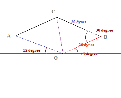

After taking a look at your book from the pdfs you uploaded, I think you miss judged the situation. The force F3 makes an angle 15 degree NOT with the resultant force.
Force F3 is actually 15 degree West of South.
First, let's work with 20 and 30 dyne. For that, we create a parallelogram.
Using cosine rule to the ΔOBC, we find OC = 16.1 (you found that too, right?)

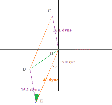

Now, we can take the third force of 40 dyne and add with 16.1
Here, we have to find OD from triangle ODE. But for applying cosine rule to ODE we should find the (green) angle ∠DEO, right?
So find ∠DOE [EDIT: should be ∠DEO]
Then we can apply the law of cosines in ΔDEO to get OD
I got OD = 32.5
To find the direction, we can first use the law of sines in ΔDEO to find ∠DOE
Which gives direction of OD as (90 - ∠DOE - 15)
The answer I got is 52 degree South of West.
Finally, I find the resultant force is about 32.5 dyne and about 52 degree south of west.
This does not completely agree with the book though (the book seems to say 37 dyne and 54 degree south of west).
By the way, as far as I know, I did it right. But sorry in advance in case I did something wrong.
I omitted some calculations because PF prohibits posting complete solutions to homework problems.
But I hope you get the idea.

I agree with everything you did on the first problem. But on the second one, how can you apply law of cosines to find green angle <Doe If you need 3 sides to find an angle yet you are only given 2 sides?
Sifuejos said:
How can you apply law of cosines to find green angle <Doe ?
I never said that I used the law of cosines to find ∠DOE. I said in order to apply cosine rule on the triangle ODE (to get OD) we need to find out ∠DOE first.
Do you know about the law of sines? http://www.mathsisfun.com/algebra/trig-sine-law.html
Yes but you are needed to start with at least one angle and none are given except for the 15 degrees South West but by the diagram you used, it does not appear to have nothing to do with the triangle <Doe
So find ∠DOE
I am really sorry. I made a typing mistake the second time. It should be ∠DEO both times.
Now this is getting a bit too long discussion. And everyone can see that you have tried for long and you seem to know all relevant equations but maybe just getting lost in the details. So I hope forum Moderators won't mind if I do a little rescue mission:
In ΔOAC the \angleCAO = 30 degree
Using the rule of sines in this tringle,
\frac{OC}{sin30} = \frac{AC}{sinAOC}
→ \frac{16.1}{sin30} = \frac{20}{sinAOC}
→ \angleAOC = 38.4 degree
Now ∠EOC = ∠AOC + 90
→ ∠EOC = 128.4 degree
So from parallelogram EOCD, ∠DEO = 180 - ∠EOC = 180 - 128.4 = 51.6 degree (that's the green angle)
Now we can apply the law of cosines in ΔDEO to get,
OD = (ED2 + OE2 - 2.OE.ED.cos(51.6))1/2
Finally, OD = 32.5
Next, to calculate direction, take ΔDEO and apply law of sines.
OD/sin∠51.5 = DE/sin∠DOE
→ 32.5/sin51.6 = 16.1/sin∠DOE
→ ∠DOE = 23
Now it can be easily seen that OD is (90-23-15) = 52 degree South of West.
