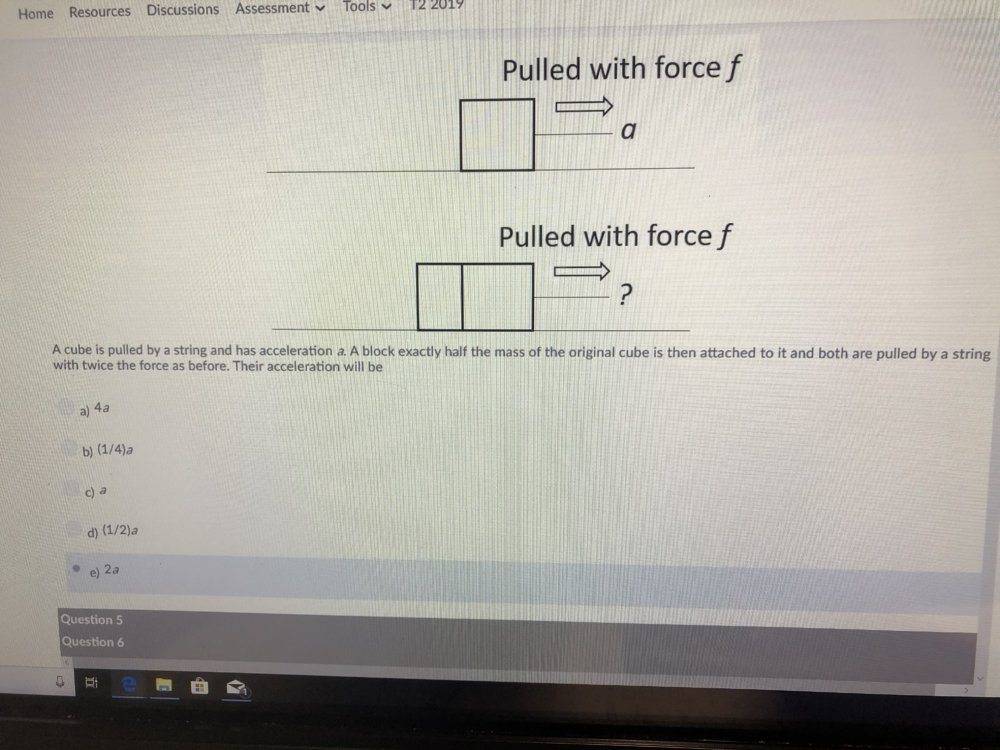

you have block A being pulled with a force. You then have block B which has an increase in mass of half the mass of the original block ( adding another 1/2 mass).
You also double the force block B is being pulled with compared to Block A.
What is the change in acceleration to block B??
F=ma
My attempt at solving this written out with random inputs
Block A- F(100)=M(10)A(10)
Block B- F(200)= M(15) A
A=200/15 = 13.33
This was not in line with options.. which were
4x block A
(1/4) block A
Equal to block A
(1/2) block A
2x block A
Much appreciated some help as I am a beginner
I think your statement of the problem is muddled. Is this a translation?
Also, your answer of 13.33 units is relative to an acceleration of 10 units for A.
It's better to work alebraically in these cases; rather than inventing some numbers for masses and forces.

Thanks for the response. Just started out with physics and trying to wrap my head around it all.
The question is basically asking if you double the force and increase the mass by another half then what will acceleration increase/decrease by.

Given that the answer to that question is not in the list of options, I doubt that is The question.
What about:
If B has half the mass of A and is subjected to twice the force, how does the acceleration of B compare with that of A?
Might that be the question?

Just for entire clarity this is the photo I just took of the question. Thanks for helping

Well, the diagram shows the same force in each case, which contradicts the text.
In either case, none of the options answers the question.
Can you do the problem as stated, using symbols for the masses, forces and accelerations?
That might be a good exercise.
