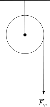

Answer choices: N2L for Translation, N2L for Rotation, Both, Either1. You are asked to find the angular acceleration of a low-friction pulley with a given force exerted on it.
My solution = N2L for rotation

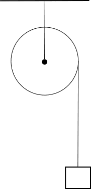

2. You are asked to find the angular acceleration of a low-friction pulley due to a mass hanging from it by a rope.
My solution = Both

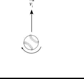

3. You are asked to determine the maximum height of a spinning ball that is thrown upwards.
My solution = Both

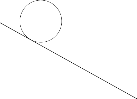

4. You are asked to calculate the time it takes a ball to roll down an inclined plane.
My solution = Both

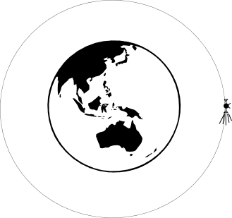

5. You are asked to find the tangential acceleration of a small satellite in a circular orbit that results from it firing its thruster.
My solution = Both

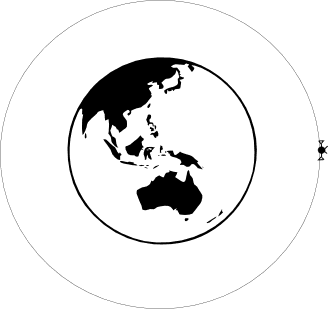

6. You are asked to determine the oribtal period of a small satellite around Earth.
My solution = N2L for translation

Let's start with #3. You were asked to find the max height that the ball get to. Why should the fact that it is spinning matter? Did you have to include the spinning part when you solve such a problem? I'm assuming that this is elementary kinematics, and that you're not including Bernoulli effect due to the spinning ball moving through air.
Zz.
Zz.
That's true. I had always imagined that the ball would be spinning when someone throws it, but I assumed something would change when we apply N2LR. I changed my answer to N2L for translation.
