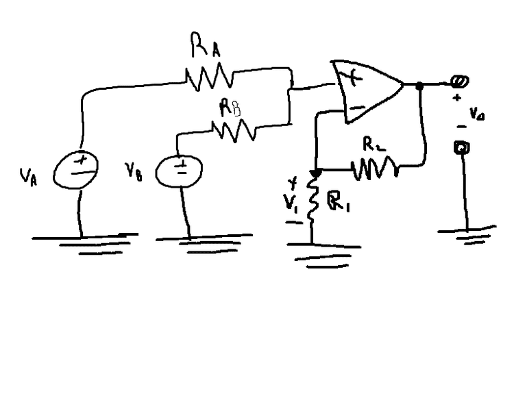

Analyze the ideal op-amp circuit shown in figure to find an expression for v0 in terms of vA,vB and the resistance values.
if i label the voltage across R1 as V1
then vi know that v1=R1/(R1+R2) *v0
but i need one more expression for v1.
i tried to use kvl in the lope (with Va,Ra and R1) but couldn't solve because of resistance Ra

What are the two basic rules governing ideal Op-Amps? (Hint: Use the voltage one, not the current one)
what do u meen with use Use the voltage one?
i tried using kvl on all the loops but coudn't solve.
current goin into the + on the amp =0 and voltage is 0 between + and - on the amp. summing point constraint.
The voltage at each of the op-amp's inputs is = V1. It's just a fact about ideal op-amps.

The current going into each input = 0 and the voltage is the same at each input. It's true for inverting and non-inverting.

Calculation is simple.
Va-V1)/Ra + Vb-V1)/Rb = 0
Solving, V1= [(Va/Ra) + (Vb/Rb)] / [(1/Ra) + (1/Rb)]
Now, Vo = [1+ (R2/R1)]V1
Substitute and you will get the answer.
