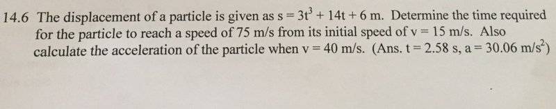

If you do this then you don't get the solution that was provided...Hamal_Arietis said:First, you must find velocity equation: v=ds/dt=f(t)
After that v=40m/s then f(t)=v=> t0
Finally, find aceleraition equation: a=dv/dt =g(t)
Replace the t0 a(t0)=g(t0)
If initial velocity is the velocity at t=0, it is not 15m/s. If you neglect the 15m/s, your answers will match the given answers.Auburn2017 said:If you do this then you don't get the solution that was provided...
Seems to me you get the given answers by taking the initial speed as 15m/s and changing the displacement to be 3t3+15t+6 to match.cnh1995 said:If initial velocity is the velocity at t=0, it is not 15m/s. If you neglect the 15m/s, your answers will match the given answers.
Right.. I meant to say neglect 14m/s and take initial velocity as 15m/s. I was about to edit but my network went off and later when I signed up again, I totally forgot that I was going to edit the post. Thanks!haruspex said:Seems to me you get the given answers by taking the initial speed as 15m/s and changing the displacement to be 3t3+15t+6 to match.
