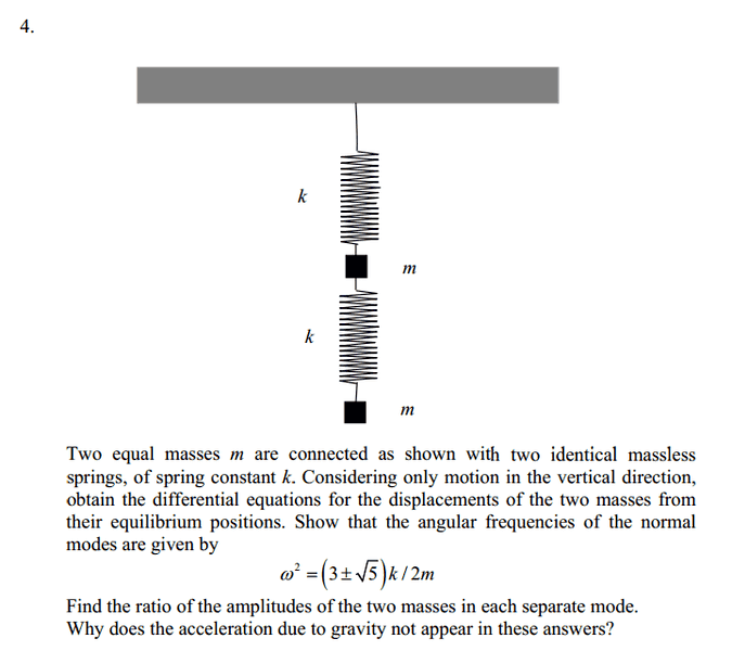

Normal Modes - 2 springs question
unscientific
1,728

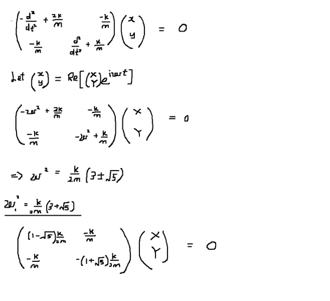

When i do the matrix multiplication of the 2x2 and 2x1 matrix, I get 2 conflicting solutions that don't match at all! So which one do i take to find ratio of X and Y?
Are you sure they don't match? What 2 conflicting solutions did you get for the ratio X/Y?
Well it's pretty obvious when it is expanded... the top entry gives something like:
(k/m)Y = (1-√5)(K/2m)X
while the bottom entry gives:
(k/m)X = -(1+√5)(K/2m)Y
Did you notice that ##(\sqrt{5}-1)(\sqrt{5}+1)=4##?
Oh I see it now, thank you!
