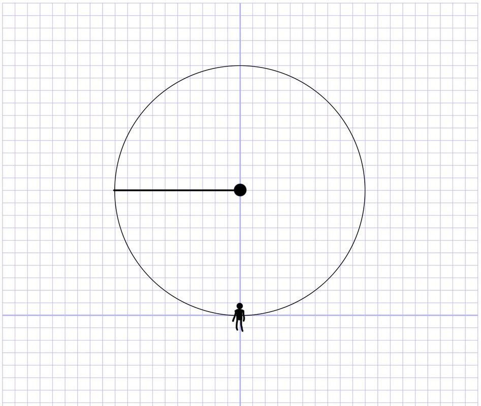

If a string of blinking Christmas lights extends from the center of a black hole out to a large radius r. What do I see, if I am perpendicular to the line of lights, at radius r?
Experiment specifics
  • 3 solar mass, non-charged, non spinning black hole.
  • Observer is 1,000 Au from the center of the black hole. ( r = 1,000au )
  • Lights are each individually battery powered. (to avoid signal complications)
  • Lights blink in perfect unison, 1 blink per second. (as measured in an inertial frame).
  • Lights are spaced 1 per meter (as measured in an inertial frame).
  • Lights emit perfectly white light (as measured in an inertial frame).
  • The ‘cable’ connecting each light to each other is indestructible and massless. (sigh)
  • The lights are bright enough to be seen at greater than 10,000au. (The energy required for such brightness is not a factor in the experiment.)
I’d like to discuss the
  1. apparent visual spacing of the lights as they approach the event horizon,
  2. the apparent flashing timing,
  3. the color of the flashes, and
  4. the total length (proper distance) of the line of Christmas Lights, vs the observed length from my frame of reference
Thoughts?

Your specification of the experiment leaves out the most important point: are the lights freely falling into the hole, or are they stationary (i.e., each light held at a fixed altitude by a rocket or some other such method)?
There are also some other issues with your formulation. The most important is that there is no such thing as "the center of a black hole" as a point in space. The "center" is a moment of time, inside the horizon, to the future of all events inside the horizon. So the inner endpoint of the string of lights can't be at the center, and you need to decide where it is--it must be somewhere outside the horizon. Where?
In addition:
First, the "as measured in an inertial frame" here must mean "as measured in a local inertial frame centered on the given light", since there are no global inertial frames in a curved spacetime. Is that what you meant?
Second, it is impossible for each light to blink once per second as measured in its local inertial frame, and for the lights to blink "in perfect unison", as in their blinks being globally synchronized. This is true whether the lights are free-falling into the hole or are stationary. So your stated scenario is impossible and cannot be analyzed. You need to make it consistent somehow: either drop the "in unison", or drop the "1 blink per second as measured in a local inertial frame". Which do you want to drop?
I think that you should plan to celebrate Christmas some other way!
