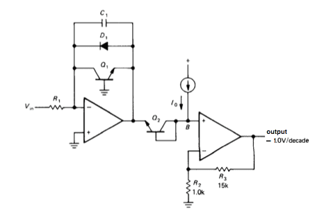

Operation of transistor in Opamp log amplifier
Connecting transistor Q1 as a diode by shorting its collector to its base would introduce a base current error, affecting the accuracy of the log amplifier. This error occurs because the base current would then contribute to the collector current, leading to incorrect output readings. The circuit utilizes the exponential relationship between Vbe and Ic to generate an output Vo = -C⋅log(Vin) - Vbeo, with the second OpAmp amplifying the log output while removing Vbeo. By keeping the base and collector at ground, the design ensures that the base current does not interfere with the collector current. This careful configuration is crucial for maintaining the integrity of the log amplifier's performance.

In the figure it could also be possible to connect the transistor Q1 as a diode by shorting its collector with its base ..but instead it is done by keeping both base and collector at ground...
The text have to say that if it would be connected the other way(i.e by shorting collector and base )then the base current would have caused an error ( Base current error ) .
Which type of error is the author talking about..?
Why and how does the error manifest itself...?
Please help!

The circuit around the first OpAmp uses the exponential relationship between Vbe and Ic in the feedback to create an output Vo = -C⋅log(Vin) - Vbeo. The circuit around the second OpAmp removes Vbeo and amplifies the log output.
If you look at Q1, you see that Ib goes from ground (constant potential) into the OpAmp output (very low output resistance) and therefore is not part of the collector current. If collector and base were shorted, the base current and the collector current would be added.
