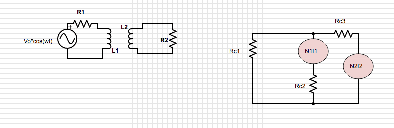

So on the left is a circuit which shows a voltage source and 2 coupled inductors in a parallel magnetic circuit shown on the right (transformer with a parallel core).
Can someone tell me if I am modelling it correctly with the following equations?
Rc1,Rc2,Rc3 are the reluctance of each branch of the transformer core
M = mutual inductance between the coils.
φ1 and φ2 are the flux on left loop and right loop of the magnetic circuit.
φ10 and φ20 are the total flux from L1 and L2 alone
$$M=k\sqrt{L1*L2}\\k=\frac{\phi_{12}}{\phi{1_0}}=\frac{\phi_{21}}{\phi{2_0}}$$
Here are the equations I came up with :
MI_2'+L_1I_1'+R_1I_1+V_0cos(wt)=0\\
MI_1'+L_2I_2'+R_2I_2=0\\
\phi_1R_{c1}+R_{c2}(\phi_1-\phi_2)=N1I1\\
\phi_2R_{c3}+R_{c2}(\phi2-\phi1)+N1I1-N2I2=0\\$$
so the total flux through path 2 (φ2)- the total flux produced by the 2nd inductor (φ20)= φ12
$$L_2I_2=N2\phi2_0\\k=\frac{\phi_{12}}{\phi1_0} \hspace{10 mm}\phi_{12}=\phi_2-L_2\frac{I_2}{N2}\\
k=\frac{(N2\phi_2-L_2I_2)N1}{N2L_1I_1}$$
Is this enough equations to solve... or am I missing an equation? If so... what equation am I missing? I think there needs to be something relating I2 to I1 without the derivatives... ?

I tried to pay for an answer, meaning If I got an answer for the current I1, I2. But after like 48 hours I went through like 5 people and did not get the answer? I pretty much got my own work shown back to me with no current.
