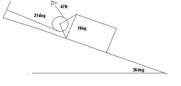

As shown in the attachment.
At the instant shown the block is moving down the slope. What is the acceleration of the block up the slope if the kinetic coefficient of friction is 0.4?
I'm having problems with two things here, the calculation of the normal reaction on the block as i don't know what to do about the angle of the line on the pulley and its resultant force...
This leads to my second problem when summing the total force in the x-direction i still don't know what to do with the 47N force...
Generally i need help!

(is 31º the angle between the upper rope and the slope, and is the lower rope suppposed to be parallel to the slope? :confused:)
There's no acceleration in the normal direction, so just use good ol' Newton's second law in that direction … ∑F = 0. :wink:
what's the x-direction?
the obvious direction to use is the direction of the slope …
then the component of the 47N in that direction is 47(cos31º)N

I assume it is.
Alright i worked it out, the tricky bit has to do with the pulley.
The total force of the pullet in the X plane is T + TcosA
The force in the normal direction (which affects friction) is mgcosA - TsinA
